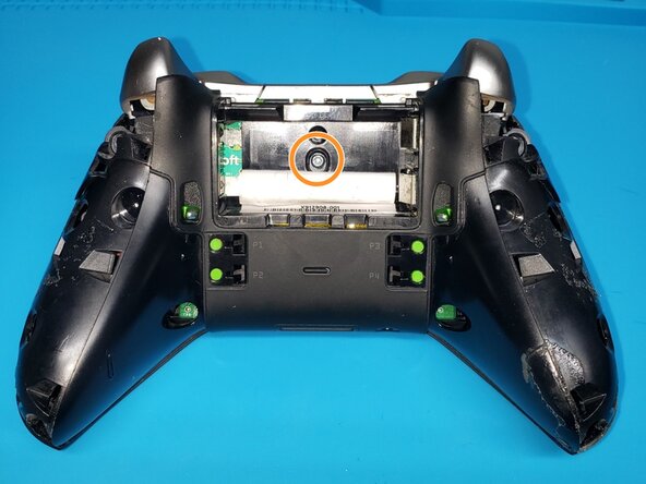

  3. Xbox One Elite Controller (Model 1698) teardown, Removing The Front Housing Shell: step 3, image 1 of 3 Xbox One Elite Controller (Model 1698) teardown, Removing The Front Housing Shell: step 3, image 2 of 3 Xbox One Elite Controller (Model 1698) teardown, Removing The Front Housing Shell: step 3, image 3 of 3
    • Remove the 4 Torx T8 screws that were covered by the rear grips.
    • Remove the Torx T8 screw behind the sticker in the battery compartment.
    • If you want to preserve the sticker carefully work the corner of the sticker free with the pry tool until it can be grabbed with you fingers, and work the the rest of the top of the sticker free and slowly peel it downward until the screw is exposed.
    • If done slowly and carefully, the sticker won't be deformed. Allowing it to be replaced by sliding a finger from the bottom part of the sticker still attached to the rear housing and moving upward during reassembly.
    • Wiggle the edges of the front housing shell to work it free. It will then come off with little effort.
