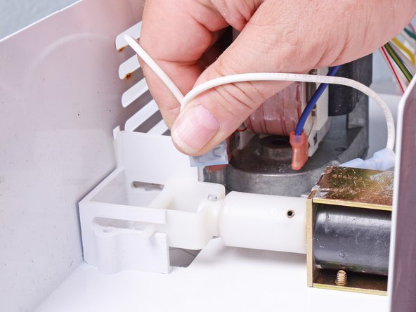

  10. Whirlpool Older Model Side‑By‑Side Refrigerator  Auger Motor Replacement, Disconnect the auger motor: step 10, image 1 of 3 Whirlpool Older Model Side‑By‑Side Refrigerator  Auger Motor Replacement, Disconnect the auger motor: step 10, image 2 of 3 Whirlpool Older Model Side‑By‑Side Refrigerator  Auger Motor Replacement, Disconnect the auger motor: step 10, image 3 of 3
    • Pull the spade connectors on the auger motor to disconnect them.
  11. Whirlpool Older Model Side‑By‑Side Refrigerator  Auger Motor Replacement: step 11, image 1 of 2 Whirlpool Older Model Side‑By‑Side Refrigerator  Auger Motor Replacement: step 11, image 2 of 2
    • Use long nose pliers to pull and disconnect the ground connector on the auger motor.

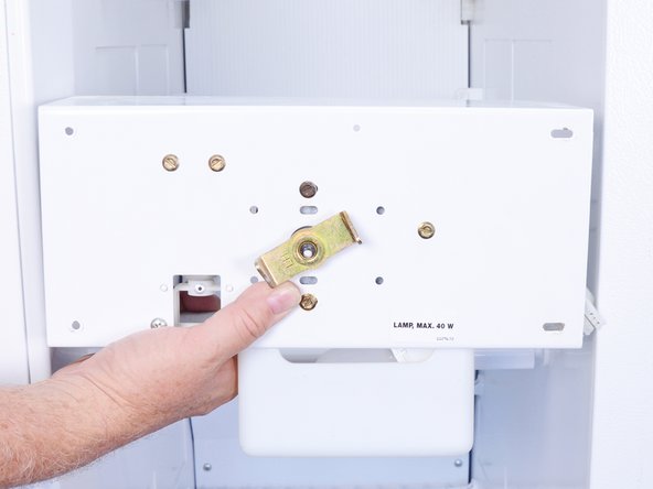

  12. Whirlpool Older Model Side‑By‑Side Refrigerator  Auger Motor Replacement, Remove the drive blade: step 12, image 1 of 2 Whirlpool Older Model Side‑By‑Side Refrigerator  Auger Motor Replacement, Remove the drive blade: step 12, image 2 of 2
    • The auger motor drive blade is removed by turning it clockwise.
    • Use a hammer to tap the blade clockwise to break it free.
  13. Whirlpool Older Model Side‑By‑Side Refrigerator  Auger Motor Replacement: step 13, image 1 of 3 Whirlpool Older Model Side‑By‑Side Refrigerator  Auger Motor Replacement: step 13, image 2 of 3 Whirlpool Older Model Side‑By‑Side Refrigerator  Auger Motor Replacement: step 13, image 3 of 3
    • Turn the blade clockwise and remove it.
