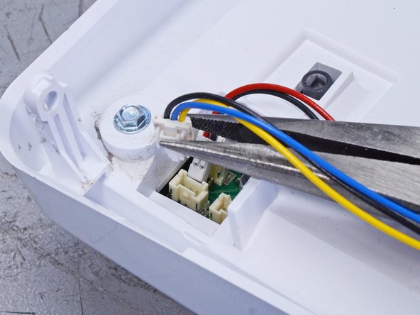

      • Disconnect the wiring harness connectors.
      • Lay the control panel down on a towel or other soft surface to perform the next few steps.

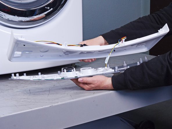

    2. Whirlpool Dryer Control Panel Replacement, Unfasten the control board: step 10, image 1 of 1
      • Remove the screws which secure the front control board to its housing.
      Ask FixBot
    3. Whirlpool Dryer Control Panel Replacement, Remove the control panel unit: step 11, image 1 of 3 Whirlpool Dryer Control Panel Replacement, Remove the control panel unit: step 11, image 2 of 3 Whirlpool Dryer Control Panel Replacement, Remove the control panel unit: step 11, image 3 of 3
      • Lift up the back plate off the control panel and remove it.
      • The control panel is a circuit board attached to a face plate. Replace the entire unit if possible.
