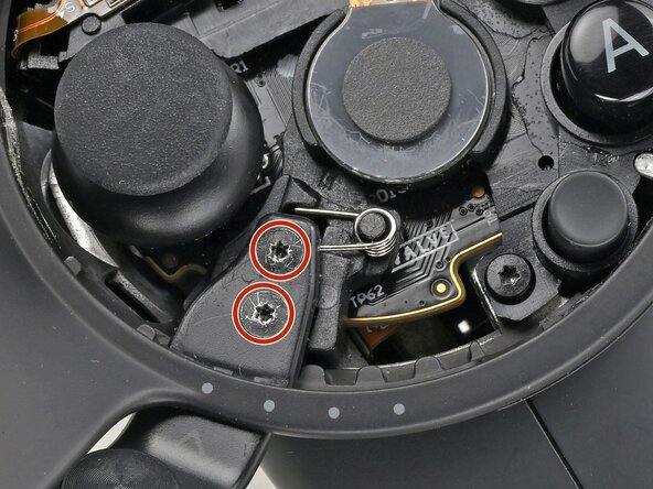

    4. Valve Index Controller Left Hand Strap Replacement, Unscrew the adjustment strap: step 4, image 1 of 3 Valve Index Controller Left Hand Strap Replacement, Unscrew the adjustment strap: step 4, image 2 of 3 Valve Index Controller Left Hand Strap Replacement, Unscrew the adjustment strap: step 4, image 3 of 3
      • Use a T5 Torx screwdriver to remove the two 6.1 mm screws securing the adjustment strap to the controller.
      • Once the adjustment strap is unscrewed, the spring underneath may fall out.
      • Make sure the spring is installed during reassembly, or the ratcheted adjustment mechanism will not work properly.

    6. Valve Index Controller Left Hand Strap Replacement, Reseating the Spring: step 6, image 1 of 1
      • If the spring falls, out, you'll need to reseat it for the adjustment mechanism to work. The spring should be located underneath the lip of the screwed-in part of the strap so that it can push against the mechanism when you push the strap in.
      • First, loosely screw the strap back in. Don't screw it in too tight, or you'll have trouble getting the spring in. Once it's screwed in, adjust the mechanism so that it's lined up with one of the pegs.
      • Place the spring so that the coil is around the nearby spoke, and the lower arm is seated in its little notch behind the strap screws.
      • You may want to use a magnetic screwdriver to seat the spring to prevent it from falling into the controller.
      • Put pressure on the coil of the spring so that it doesn't fly out, and move the arm of the spring over the top of the fastener, and push it in so that it stays underneath the lip.
      • While keeping pressure on the coil, quickly tighten the screws. Tighten the screw closest to the spring first. This will prevent the spring from unseating itself and springing back out.
