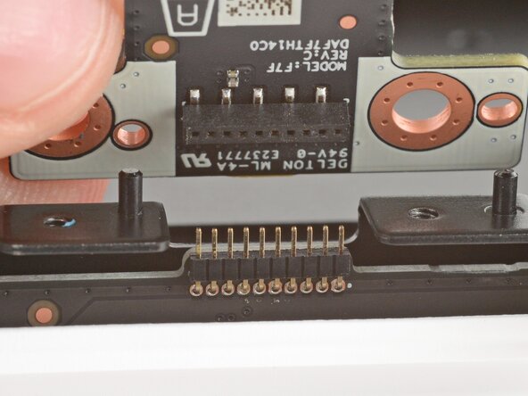

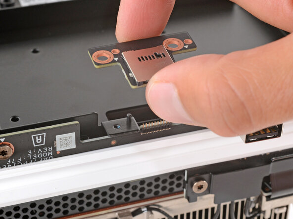

    1. Steam Machine (2026) microSD Card Reader Replacement, Remove the microSD card reader screws: step 9, image 1 of 2 Steam Machine (2026) microSD Card Reader Replacement, Remove the microSD card reader screws: step 9, image 2 of 2
      • Use a T8 Torx screwdriver to remove the two 5.1 mm‑long screws securing the microSD card reader.
      Ask FixBot
    2. Steam Machine (2026) microSD Card Reader Replacement, Remove the microSD card reader: step 10, image 1 of 3 Steam Machine (2026) microSD Card Reader Replacement, Remove the microSD card reader: step 10, image 2 of 3 Steam Machine (2026) microSD Card Reader Replacement, Remove the microSD card reader: step 10, image 3 of 3
      • After the screws are removed, the microSD card reader is held in place by a socket on its underside that plugs into pins on the board below it.
      • Pull the microSD card reader straight up to disconnect and remove it.
