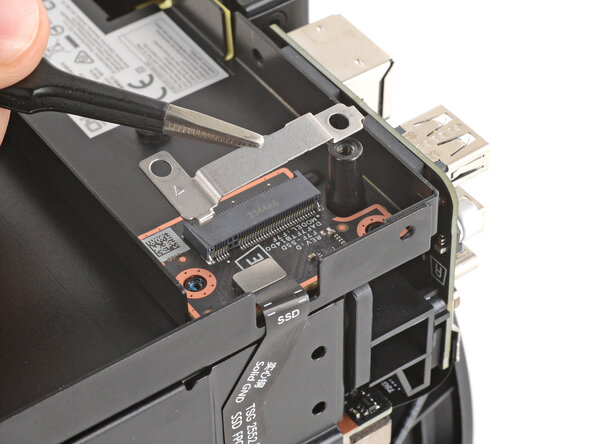

    1. Steam Machine (2026) SSD Board Replacement, Remove the SSD board screws: step 12, image 1 of 2 Steam Machine (2026) SSD Board Replacement, Remove the SSD board screws: step 12, image 2 of 2
      • Use a T8 Torx screwdriver to remove the two 5.1 mm‑long screws securing the SSD board and its cover.
      • With the screws removed, the board is only attached by its ribbon cable.
      Ask FixBot
    2. Steam Machine (2026) SSD Board Replacement, Remove the SSD board cable cover: step 13, image 1 of 2 Steam Machine (2026) SSD Board Replacement, Remove the SSD board cable cover: step 13, image 2 of 2
      • Remove the cover.
      Ask FixBot
    3. Steam Machine (2026) SSD Board Replacement, Disconnect the SSD board: step 14, image 1 of 2 Steam Machine (2026) SSD Board Replacement, Disconnect the SSD board: step 14, image 2 of 2
      • With one hand, hold the board down by the SSD socket.
      • With your free hand, use the flat end of a spudger to pry up and disconnect the board's press connector.
      Ask FixBot
    4. Steam Machine (2026) SSD Board Replacement, Remove the SSD board: step 15, image 1 of 2 Steam Machine (2026) SSD Board Replacement, Remove the SSD board: step 15, image 2 of 2
      • Lift the SSD board straight up and remove it.
      Ask FixBot
