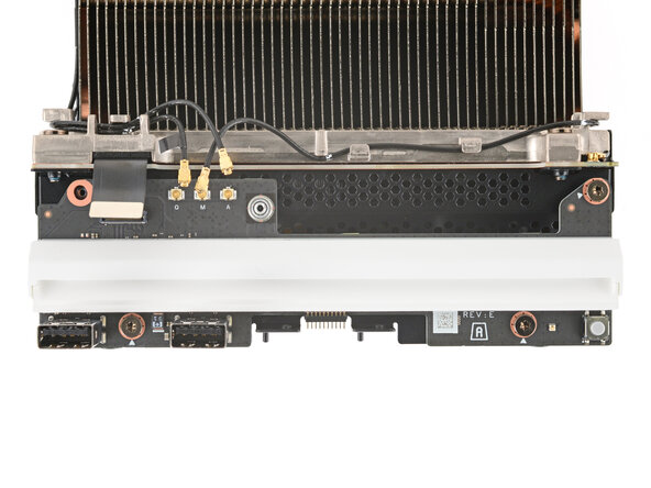

    2. Steam Machine (2026) Front USB and Power Button Board Replacement, Remove the cable cover screws: step 12, image 1 of 2 Steam Machine (2026) Front USB and Power Button Board Replacement, Remove the cable cover screws: step 12, image 2 of 2
      • Use a T8 Torx screwdriver to remove the two 5.1 mm‑long screws securing the front port cable cover.
      Ask FixBot
    3. Steam Machine (2026) Front USB and Power Button Board Replacement, Remove the cable cover: step 13, image 1 of 2 Steam Machine (2026) Front USB and Power Button Board Replacement, Remove the cable cover: step 13, image 2 of 2
      • Remove the cable cover.
      Ask FixBot
    4. Steam Machine (2026) Front USB and Power Button Board Replacement, Disconnect the front port board: step 14, image 1 of 2 Steam Machine (2026) Front USB and Power Button Board Replacement, Disconnect the front port board: step 14, image 2 of 2
      • Use the flat end of a spudger to pry up and disconnect the board's press connector.
      Ask FixBot

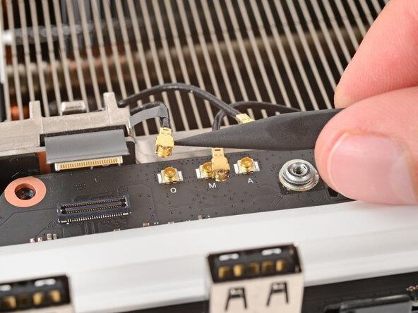

    5. Steam Machine (2026) Front USB and Power Button Board Replacement: step 15, image 1 of 3 Steam Machine (2026) Front USB and Power Button Board Replacement: step 15, image 2 of 3 Steam Machine (2026) Front USB and Power Button Board Replacement: step 15, image 3 of 3
      • Use the point of a spudger to lift and disconnect the three coaxial connectors, making sure to lift as close to the connector head as possible.

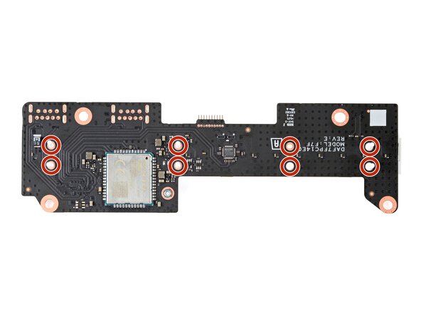

    8. Steam Machine (2026) Front USB and Power Button Board Replacement, Reassembly information: step 18, image 1 of 3 Steam Machine (2026) Front USB and Power Button Board Replacement, Reassembly information: step 18, image 2 of 3 Steam Machine (2026) Front USB and Power Button Board Replacement, Reassembly information: step 18, image 3 of 3
      • If your replacement board doesn't come with a white light guide, follow this step to transfer the old one.
      • The light guide is secured with plugs that go through the board.
      • Pull up the light guide and remove it, being careful not to rip off any of the plugs.
      • Align the light guide over your replacement board and slowly pull each plug through the hole, letting it stretch until it can slide through.
      • Don't yank on the plugs, or they'll break. Apply constant pressure to allow them to slide through.
