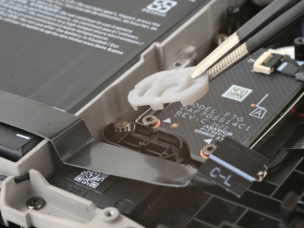

    1. Steam Deck OLED Left Touchpad Replacement, Remove the Steam button membrane: step 22, image 1 of 2 Steam Deck OLED Left Touchpad Replacement, Remove the Steam button membrane: step 22, image 2 of 2
      Tool used on this step:
      Buy
      • Use tweezers to remove the Steam button membrane.

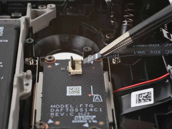

    2. Steam Deck OLED Left Touchpad Replacement, Remove the left touchpad board cable: step 23, image 1 of 3 Steam Deck OLED Left Touchpad Replacement, Remove the left touchpad board cable: step 23, image 2 of 3 Steam Deck OLED Left Touchpad Replacement, Remove the left touchpad board cable: step 23, image 3 of 3
      • Flip up the small locking flap on the left touchpad board ZIF connector.
      • Lift the connector until its arms are free of the socket and slide it straight out to disconnect it.
      Ask FixBot

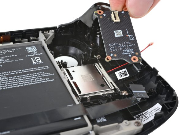

    3. Steam Deck OLED Left Touchpad Replacement, Remove the touchpad board screws: step 24, image 1 of 1
      • Use your T6 Torx driver to remove the four 5 mm‑long screws securing the touchpad board.
      Ask FixBot

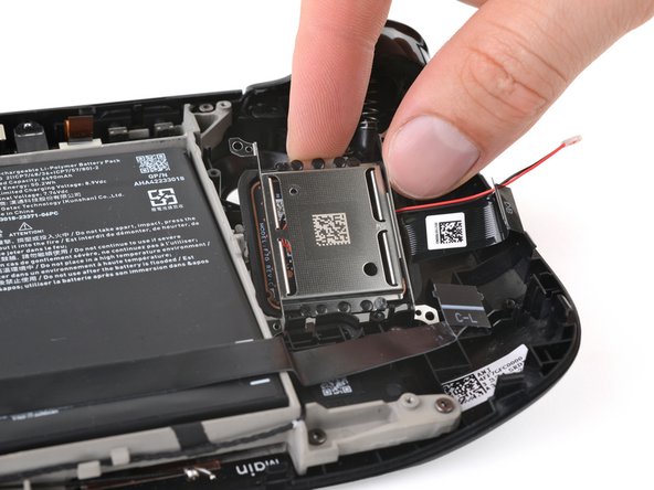

    4. Steam Deck OLED Left Touchpad Replacement, Remove the touchpad board: step 25, image 1 of 2 Steam Deck OLED Left Touchpad Replacement, Remove the touchpad board: step 25, image 2 of 2
      • Use your fingers to remove the touchpad board.
      Ask FixBot

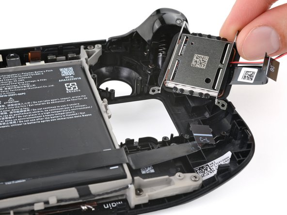

    6. Steam Deck OLED Left Touchpad Replacement, Remove the touchpad: step 27, image 1 of 3 Steam Deck OLED Left Touchpad Replacement, Remove the touchpad: step 27, image 2 of 3 Steam Deck OLED Left Touchpad Replacement, Remove the touchpad: step 27, image 3 of 3
