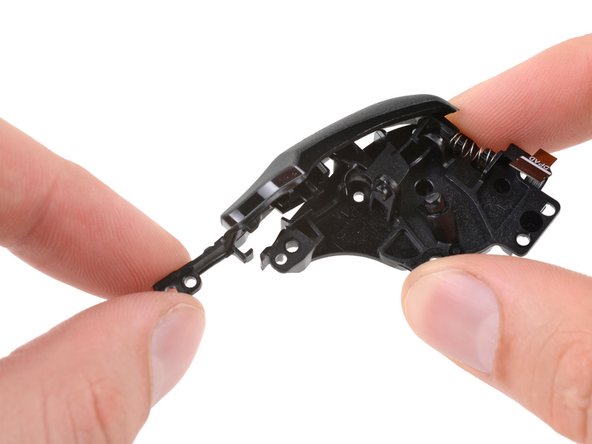

  25. Steam Deck OLED Left Bumper Replacement, Remove the bumper: step 25, image 1 of 3 Steam Deck OLED Left Bumper Replacement, Remove the bumper: step 25, image 2 of 3 Steam Deck OLED Left Bumper Replacement, Remove the bumper: step 25, image 3 of 3
    • The bumper connects to its bracket with a spring on the outside edge, an alignment post in the middle, and a clip on the inside edge.
    • Gently pull the inside arm of the bumper away from the bracket to free the clip securing it.
    • Remove the bumper.
