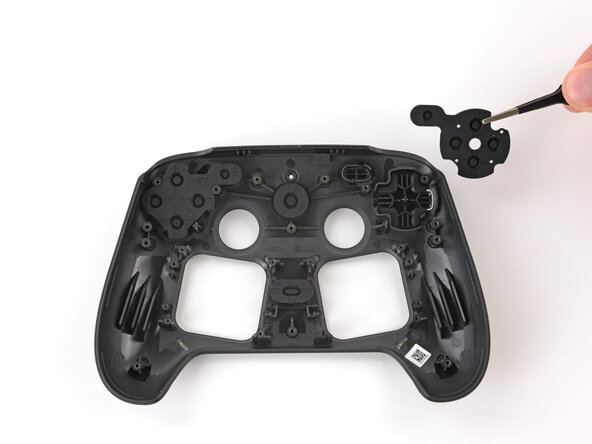

    3. Steam Controller (2nd Gen, 2026) Front Shell Replacement, Remove the button membranes: step 29, image 1 of 3 Steam Controller (2nd Gen, 2026) Front Shell Replacement, Remove the button membranes: step 29, image 2 of 3 Steam Controller (2nd Gen, 2026) Front Shell Replacement, Remove the button membranes: step 29, image 3 of 3
      • Remove the four silicone button membranes.
      Ask FixBot

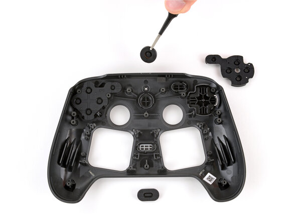

    4. Steam Controller (2nd Gen, 2026) Front Shell Replacement, Remove the buttons: step 30, image 1 of 3 Steam Controller (2nd Gen, 2026) Front Shell Replacement, Remove the buttons: step 30, image 2 of 3 Steam Controller (2nd Gen, 2026) Front Shell Replacement, Remove the buttons: step 30, image 3 of 3
      • Use tweezers to remove the D‑Pad, View, Steam, Menu, ABXY, and Quick Access Menu buttons.
      • Alternatively, you can flip the front case over and let the buttons fall out.
      • During reassembly, use the alignment tabs to orient each button in its recess. Each one is keyed for proper location and orientation.
      Ask FixBot
    5. Steam Controller (2nd Gen, 2026) Front Shell Replacement, Remove the button dampeners: step 31, image 1 of 3 Steam Controller (2nd Gen, 2026) Front Shell Replacement, Remove the button dampeners: step 31, image 2 of 3 Steam Controller (2nd Gen, 2026) Front Shell Replacement, Remove the button dampeners: step 31, image 3 of 3
      • Use tweezers or a spudger to remove all the button dampeners (they surround the button recesses) from the front shell.
      • During reassembly, transfer the dampeners to your new shell. Use a spudger to push them down so they're fully seated against the shell.
      Ask FixBot
