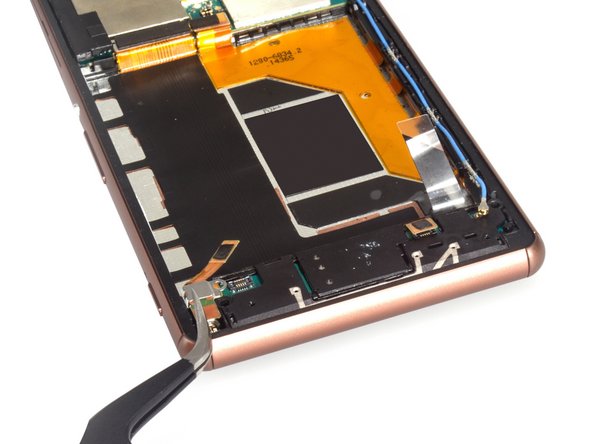

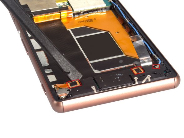

  5. Sony Xperia Z3 Dual LCD screen Replacement: step 5, image 1 of 3 Sony Xperia Z3 Dual LCD screen Replacement: step 5, image 2 of 3 Sony Xperia Z3 Dual LCD screen Replacement: step 5, image 3 of 3
    • Remove the two screws with a Philips screwdriver.
    • Release the three connectors connected to the loudspeaker assembly.
    • Remove the vibrator securing bracket (this may be optional for some devices).

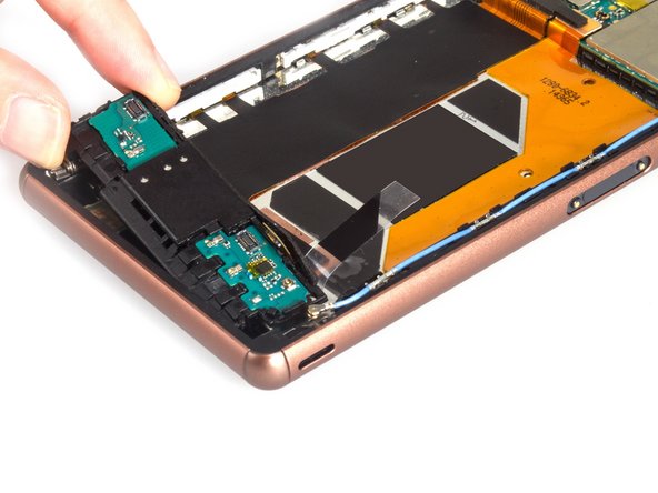

  6. Sony Xperia Z3 Dual LCD screen Replacement: step 6, image 1 of 3 Sony Xperia Z3 Dual LCD screen Replacement: step 6, image 2 of 3 Sony Xperia Z3 Dual LCD screen Replacement: step 6, image 3 of 3
    • Remove the loudspeaker assembly cover. Tip: pull it toward the centre of the phone as you pull upwards.
    • Pry up and remove the loudspeaker assembly.
    • Carefully loosen the microphone here.

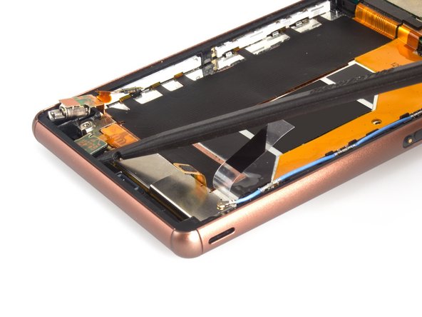

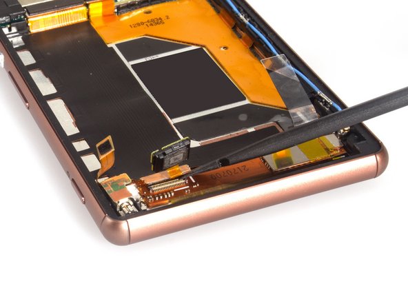

  7. Sony Xperia Z3 Dual LCD screen Replacement: step 7, image 1 of 3 Sony Xperia Z3 Dual LCD screen Replacement: step 7, image 2 of 3 Sony Xperia Z3 Dual LCD screen Replacement: step 7, image 3 of 3
    • Carefully remove the metal LCD flex cover.
    • Release the LCD connector from the main flex cable.
    • Carefully pry the LCD connector from the sticker underneath.

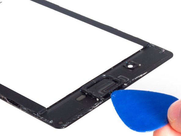

  10. Sony Xperia Z3 Dual LCD screen Replacement, Kindly Remind: step 10, image 1 of 2 Sony Xperia Z3 Dual LCD screen Replacement, Kindly Remind: step 10, image 2 of 2
    • It's a weird design that the earpiece speaker is stuck onto the Sony Xperia Z3 front glass and not the supporting frame. It means it is possible to remove the LCD screen with the earpiece speaker attached, or separate the speaker from its securing bracket.
    • The above steps depend on the length of the guitar pick that you use.
