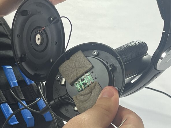

    1. Sennheiser HD205 Audio Cable Replacement, Audio Cable: step 2, image 1 of 3 Sennheiser HD205 Audio Cable Replacement, Audio Cable: step 2, image 2 of 3 Sennheiser HD205 Audio Cable Replacement, Audio Cable: step 2, image 3 of 3
      • Using the 00-size screw bit, remove the four screws and plastic cover from headphones.
      • Flip over plastic cover to find headphone cable connection.

    2. Sennheiser HD205 Audio Cable Replacement: step 3, image 1 of 3 Sennheiser HD205 Audio Cable Replacement: step 3, image 2 of 3 Sennheiser HD205 Audio Cable Replacement: step 3, image 3 of 3
      • Use a soldering iron to desolder the audio cable from the headphones.
