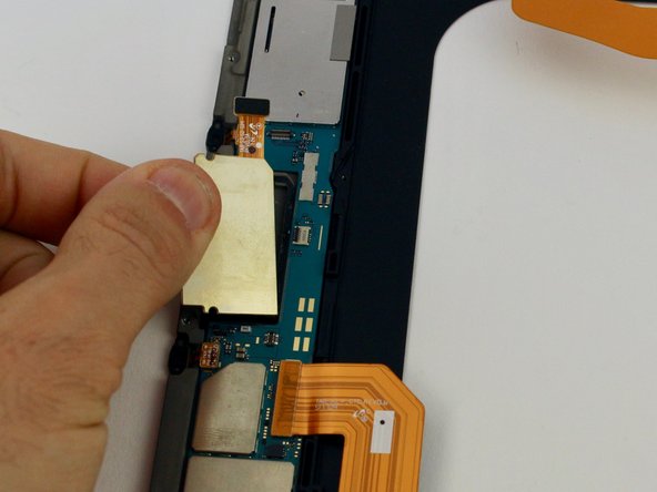

  12. Samsung Galaxy Tab S3 Micro SD Card Reader Replacement, Micro SD Card Reader: step 12, image 1 of 3 Samsung Galaxy Tab S3 Micro SD Card Reader Replacement, Micro SD Card Reader: step 12, image 2 of 3 Samsung Galaxy Tab S3 Micro SD Card Reader Replacement, Micro SD Card Reader: step 12, image 3 of 3
    • Disconnect the single press fit connector located just above the Micro SD card tray on the left midframe.
  13. Samsung Galaxy Tab S3 Micro SD Card Reader Replacement: step 13, image 1 of 3 Samsung Galaxy Tab S3 Micro SD Card Reader Replacement: step 13, image 2 of 3 Samsung Galaxy Tab S3 Micro SD Card Reader Replacement: step 13, image 3 of 3
    • Next pry the Micro SD card tray up from the midframe on the left with your finger.
    • There is a layer of glue around the perimeter, so prying from the left, then downward should free the card reader from its sticky spot.
    • Remove the Micro SD card reader.
