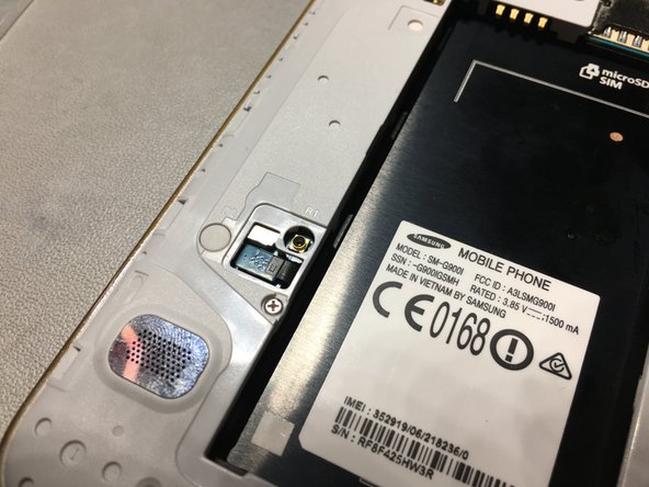

    • Use a plastic opening tool to pry up the plastic midframe connector panel.
    • Remove the connector panel with a pair of tweezers.
    • There should be enough adhesive to readhere the panel upon reassembly, otherwise use a small amount of double-stick tape.

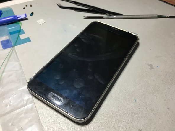

  17. Samsung Galaxy S5 Fingerprint Reader Replacement, Replacing a torn home button cable: step 17, image 1 of 2 Samsung Galaxy S5 Fingerprint Reader Replacement, Replacing a torn home button cable: step 17, image 2 of 2
    • For this guide I am demonstrating on a Samsung Galaxy S5 which had the fingerprint reader cable for the home button torn.
    • The home button 'press' is still functional with the underlying button (see second photo), but this guide restores your fingerprint scanner.

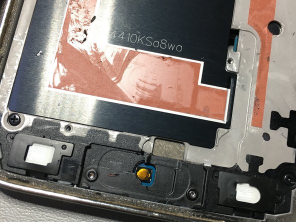

  18. Samsung Galaxy S5 Fingerprint Reader Replacement, Home button cable socket: step 18, image 1 of 1
    • Make sure there isn't anything still connected in this socket.
  19. Samsung Galaxy S5 Fingerprint Reader Replacement, Remove remaining adhesive: step 19, image 1 of 1
    • Scrape the remaining adhesive from the edges of the midframe using a plastic pry tool.

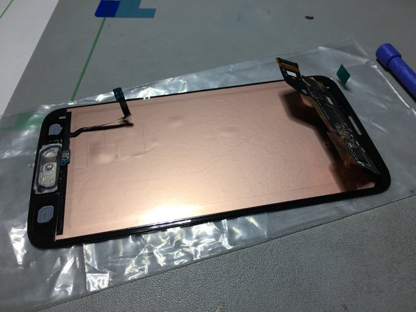

  20. Samsung Galaxy S5 Fingerprint Reader Replacement, Home button cable: step 20, image 1 of 1
  21. Samsung Galaxy S5 Fingerprint Reader Replacement, Attaching the home button: step 21, image 1 of 2 Samsung Galaxy S5 Fingerprint Reader Replacement, Attaching the home button: step 21, image 2 of 2
    • Attach the home button to the screen assembly. In this guide I am also installing a new screen assembly.
  22. Samsung Galaxy S5 Fingerprint Reader Replacement, Preparing the display: step 22, image 1 of 2 Samsung Galaxy S5 Fingerprint Reader Replacement, Preparing the display: step 22, image 2 of 2
    • Prepare your screen assembly by removing adhesive film. If you're not replacing the screen then you can skip this step.

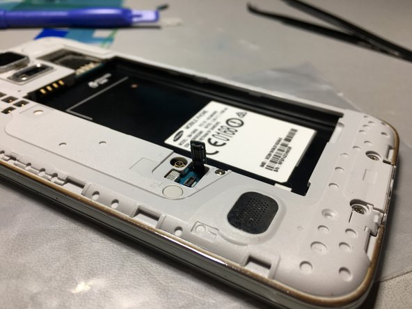

  24. Samsung Galaxy S5 Fingerprint Reader Replacement, Fitting the display: step 24, image 1 of 3 Samsung Galaxy S5 Fingerprint Reader Replacement, Fitting the display: step 24, image 2 of 3 Samsung Galaxy S5 Fingerprint Reader Replacement, Fitting the display: step 24, image 3 of 3
    • Plug the home button cable into the socket.
    • Stick the screen assembly back down to the rest of the phone.

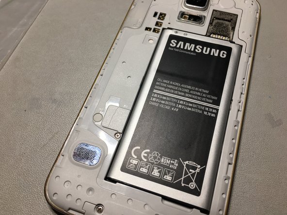

  25. Samsung Galaxy S5 Fingerprint Reader Replacement, Battery: step 25, image 1 of 2 Samsung Galaxy S5 Fingerprint Reader Replacement, Battery: step 25, image 2 of 2
    • Reinstall the battery.
    • Remember to place the plastic panel back on the phone.

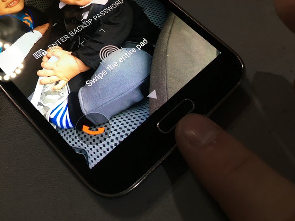

  27. Samsung Galaxy S5 Fingerprint Reader Replacement, Power on and test: step 27, image 1 of 2 Samsung Galaxy S5 Fingerprint Reader Replacement, Power on and test: step 27, image 2 of 2
    • Power on the device and test the new fingerprint scanner.
If you have followed this guide correctly you should now have a functional fingerprint reader on your Samsung Galaxy S5.
