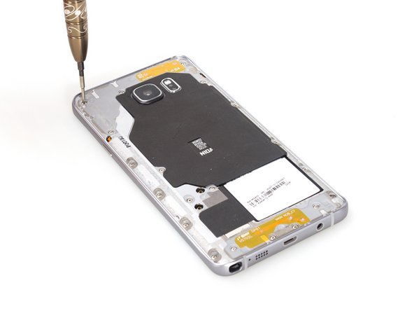

    4. Samsung Galaxy Note5 Middle Housing Replacement: step 4, image 1 of 2 Samsung Galaxy Note5 Middle Housing Replacement: step 4, image 2 of 2
      • Remove screws.

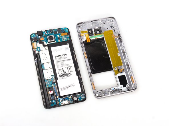

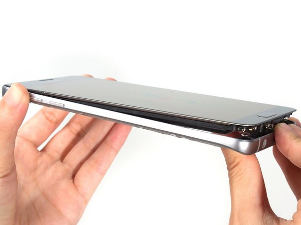

    5. Samsung Galaxy Note5 Middle Housing Replacement: step 5, image 1 of 3 Samsung Galaxy Note5 Middle Housing Replacement: step 5, image 2 of 3 Samsung Galaxy Note5 Middle Housing Replacement: step 5, image 3 of 3
      • Push to separate the middle housing from front assembly. There is a little adhesive around every corner. The middle housing comes with power button flex, volume button flex, loudspeaker and wireless charging film.
