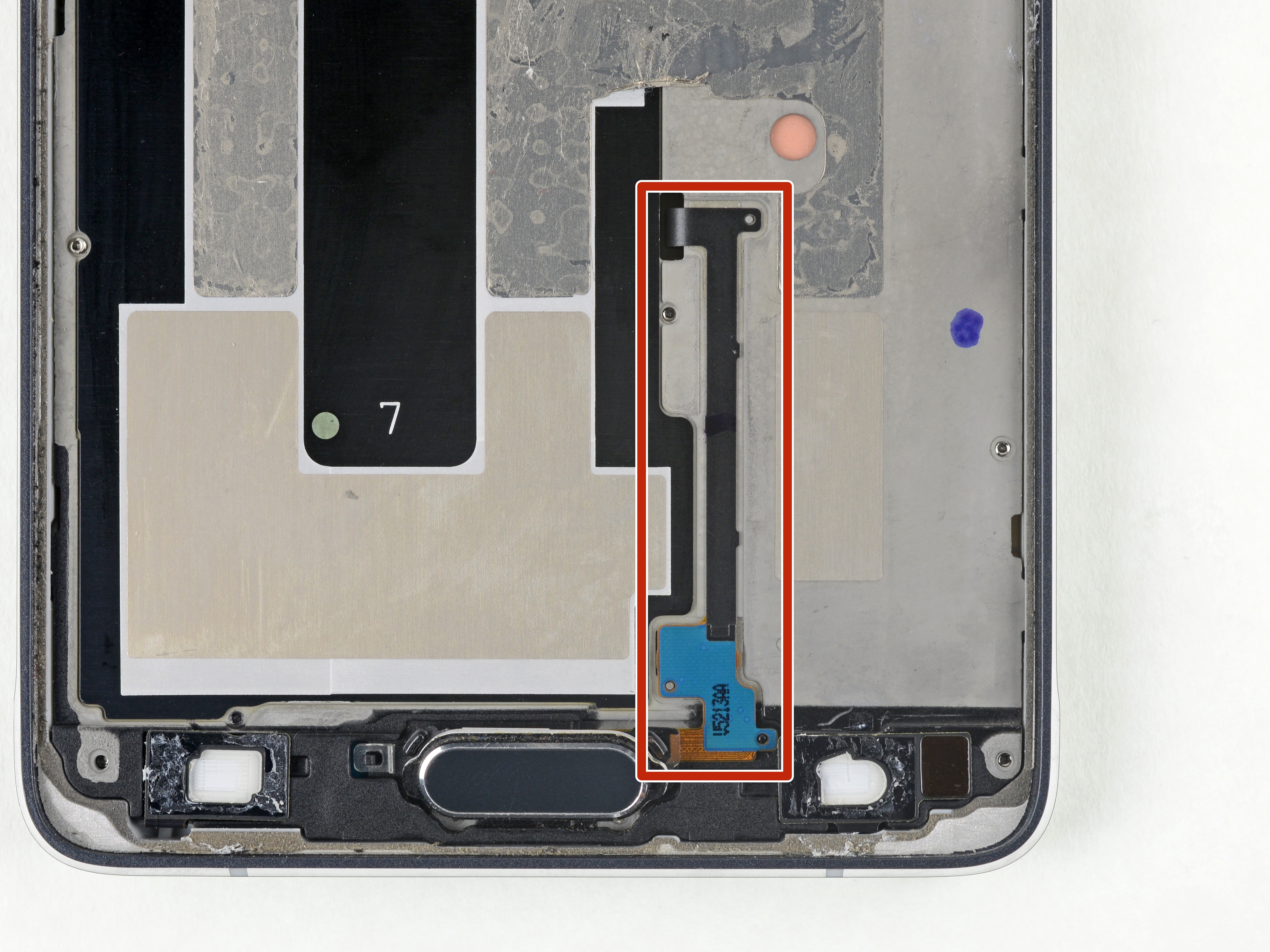

      • Don't insert the pick more than 1 inch (25 mm) underneath the display to avoid damaging the home button cable.
      • The display and digitizer cables are located near the top of the display and may interfere with your pick if you pry too deeply.

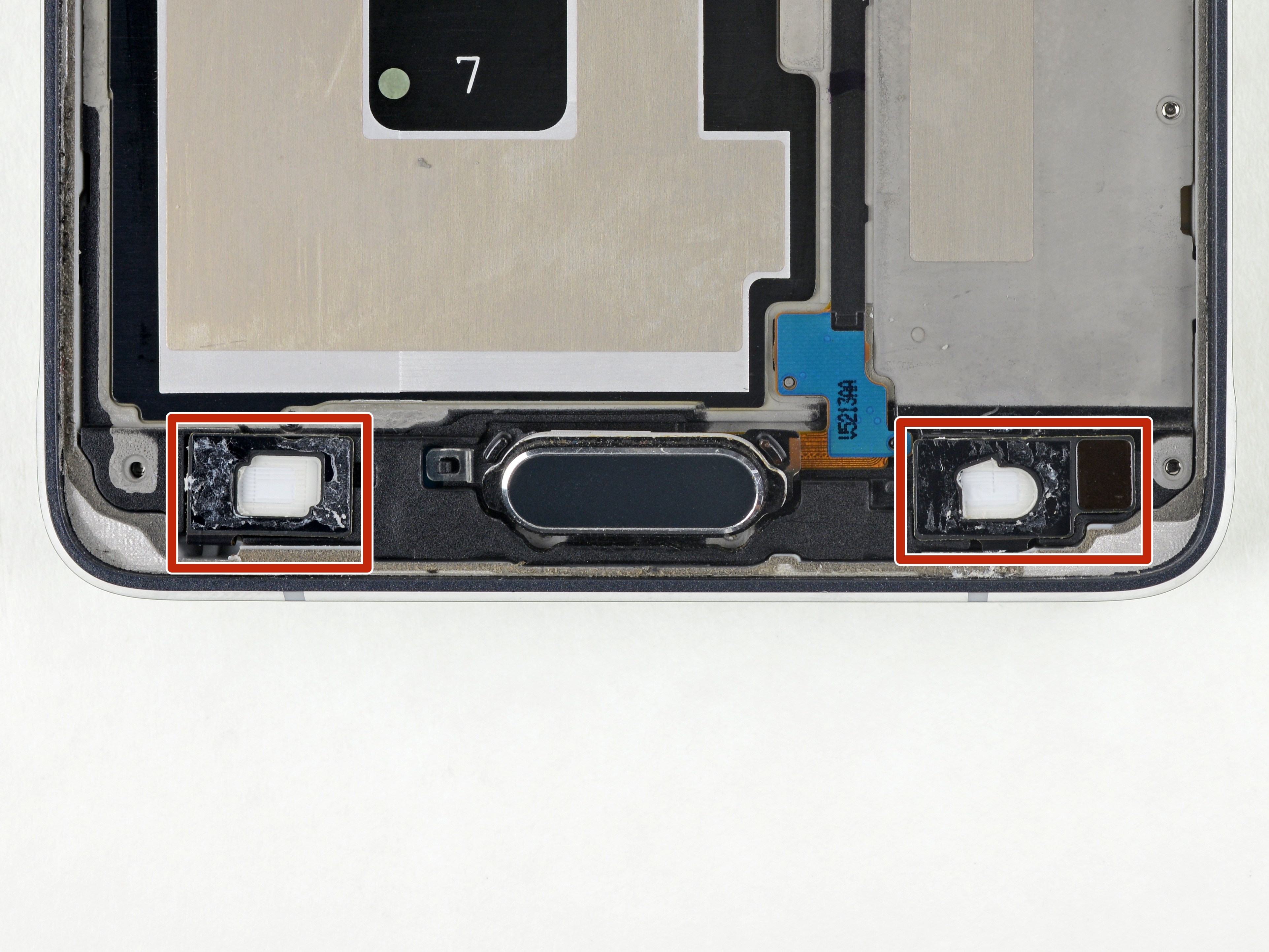

      • Before installing a new display, it's very important to remove all traces of the old adhesive from the frame, while taking special care to remove any small glass fragments.
      • After removing all traces of glue and glass from the frame, clean the adhesion areas with 90% (or higher) isopropyl alcohol and a lint-free cloth or coffee filter. Swipe in one direction only, not back and forth.
      • If the frame is bent, or if any glue or glass remnants are left behind, the new display will not mount correctly and may be damaged.
      • The best way to secure the new screen is with a sheet of custom-cut double-sided tape. Apply the tape to the back of the screen, then carefully feed the display cable through the frame. Align the screen and press it into place.
