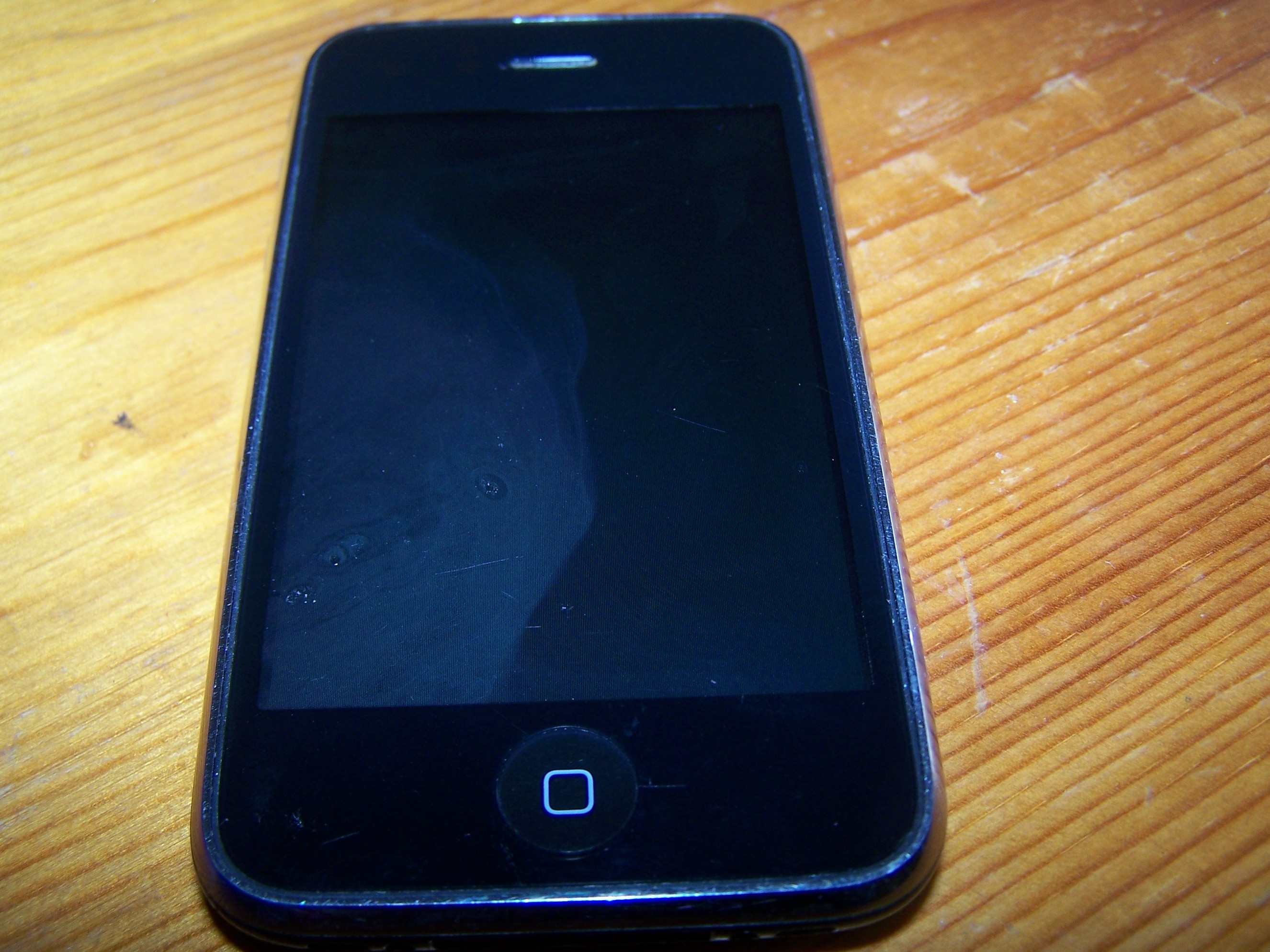

  1. Repairing iPhone Liquid Damage, Assessing visible external damage: step 1, image 1 of 3 Repairing iPhone Liquid Damage, Assessing visible external damage: step 1, image 2 of 3 Repairing iPhone Liquid Damage, Assessing visible external damage: step 1, image 3 of 3
    • Look for liquid or residue between the touchscreen and LCD. This phone shows water build-up between the touchscreen and LCD, and most likely contains more liquid inside.
    • In this case, there is no obvious damage or corrosion in the external dock connector.
    • There is no obvious damage or corrosion in the headphone jack.

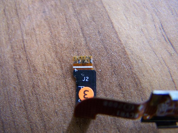

    • The rear of the display assembly shows more green corrosion and debris on the LCD and digitizer connectors.

  6. Repairing iPhone Liquid Damage: step 6, image 1 of 1
    • Closer inspection of proximity sensor/earpiece flex reveals more corrosion damage.
