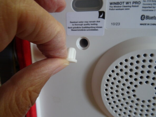

    2. Repairing a Broken Bumper, Removing the hidden screw on the bottom cover: step 2, image 1 of 2 Repairing a Broken Bumper, Removing the hidden screw on the bottom cover: step 2, image 2 of 2
      • Use a pointed tool to peel off the rubber cap on the underside.
      • Remove the screw underneath.
      • Turn the device over.
      • Carefully lift the top cover slightly. Be careful not to strain the cables underneath too much.
      Ask FixBot

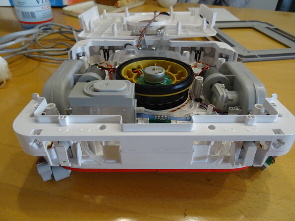

    3. Repairing a Broken Bumper, Flip up the top cover: step 3, image 1 of 1
      • Remove the two cable bundles from their retaining clips.
      • You can now flip up the top cover to access all the components inside.
      • Pay special attention to the blower motor; it sits loosely between two soft rubber seals. It must be tightly enclosed again during reassembly.

    4. Repairing a Broken Bumper: step 7, image 1 of 2 Repairing a Broken Bumper: step 7, image 2 of 2
      • Here is the device shown with the bumper removed.

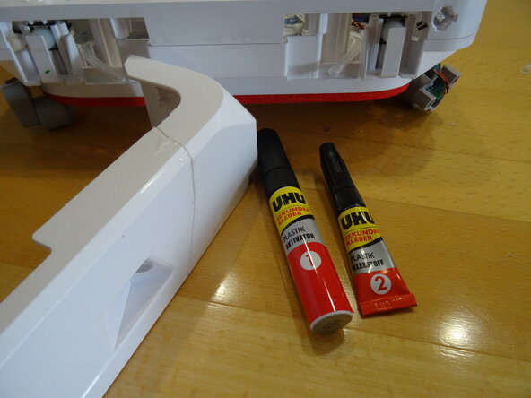

    5. Repairing a Broken Bumper, Bumper glued: step 8, image 1 of 1
      • The bumper is made of ABS, which can be easily glued using a suitable adhesive—in this case, superglue with an activator.
      Ask FixBot
Follow the steps in reverse order to reassemble your device.
