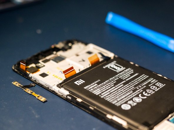

      • Gently separate the side button bar from the frame

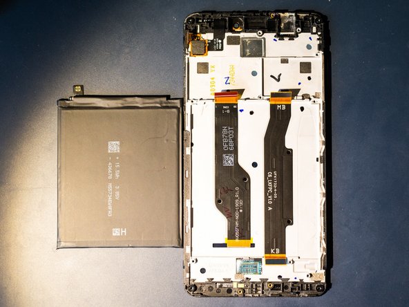

      • Peel off the two battery adhesive strips to remove the battery
      • Pull as flat as possible and rather slowly. Heating the display with a hair dryer makes the whole thing a little easier.

    13. Redmi Note 4 Global Display Replacement: step 13, image 1 of 1
      • Disconnect the ribbon cable for the charging board. Keep it safe for later reuse.
