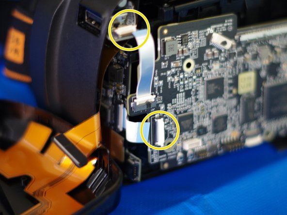

    3. Razer OSVR HDK 1.4 Screen Replacement, Disconnect the Board: step 3, image 1 of 3 Razer OSVR HDK 1.4 Screen Replacement, Disconnect the Board: step 3, image 2 of 3 Razer OSVR HDK 1.4 Screen Replacement, Disconnect the Board: step 3, image 3 of 3
      • Both of these connectors slide out. I have also removed the cable holder plate from the top.
      • The two ribbon connectors on the left side flip open and the ribbon pops out. I used the spudger tool that came with my iFixIt kit.
      • To put it back together, you slide the ribbon back in until you can see about half the blue and close them back.

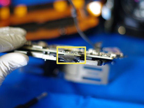

    4. Razer OSVR HDK 1.4 Screen Replacement, Disconnecting the Screen: step 4, image 1 of 2 Razer OSVR HDK 1.4 Screen Replacement, Disconnecting the Screen: step 4, image 2 of 2
      • Gently peel back the tape on the bottom right. There is a connector on the other side for the screen.
      • I have included a picture of this connector from reassembly for your information.
      • Gently separate the board from the back of the screen, careful with the screen connector and the connector on the top right if you left it attached.

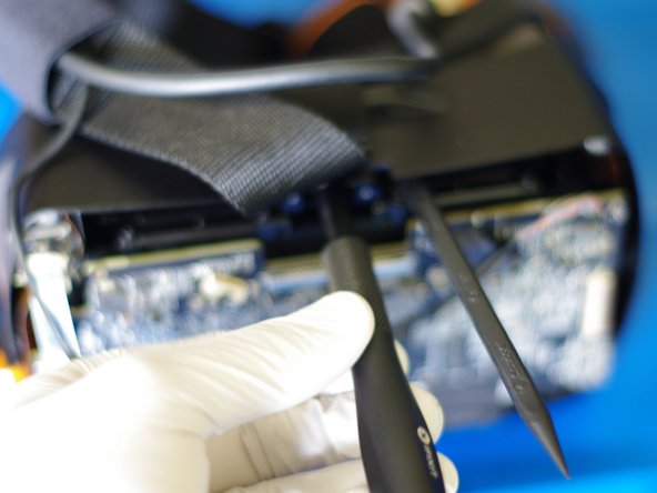

    5. Razer OSVR HDK 1.4 Screen Replacement, Unscrewing the Screen: step 5, image 1 of 3 Razer OSVR HDK 1.4 Screen Replacement, Unscrewing the Screen: step 5, image 2 of 3 Razer OSVR HDK 1.4 Screen Replacement, Unscrewing the Screen: step 5, image 3 of 3
      • Unscrew the two shallow screws and the one deep screw with the Phillips #1 bit.
      • There's a ribbon that I have marked in yellow that makes the deep screw hard to come out. I used my spudger to lift it up. Please note that the picture with the spudger is from reassembly.
