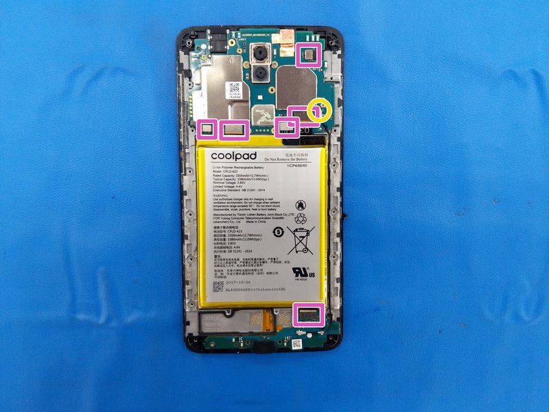

    1. REVVL Plus Display assembly (with frame) Replacement, Display assembly (with frame): step 6, image 1 of 1
      • These pictures show the battery still installed as it is easiest to remove the battery last.
      • Disconnect 6 flex cables from the mother- and daughter-board.
      • Disconnect the antenna cable and remove it from its channel on the frame.
