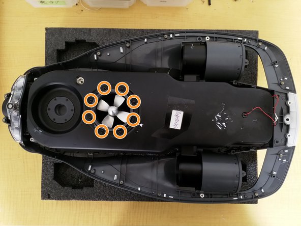

    4. PowerRay Vertical Motor Unit Replacement, Removing the Hermetic Module: step 4, image 1 of 3 PowerRay Vertical Motor Unit Replacement, Removing the Hermetic Module: step 4, image 2 of 3 PowerRay Vertical Motor Unit Replacement, Removing the Hermetic Module: step 4, image 3 of 3
      • Remove any screws that secure the hermetic module to the exterior
      • Red M2.5×12 (8 pcs)
      • Green M2×5 (4 copies)
      • Removing the fixing screws of the vertical motor unit
      • M2.5×8(8Book)
