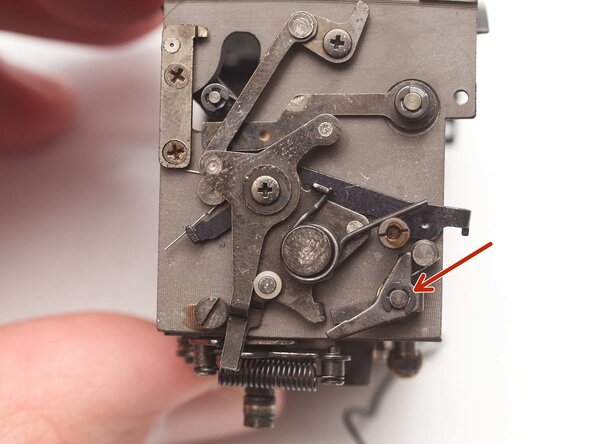

    3. Pentax MX Mirror Box Mechanism Disassembly, Remove mirror release latch: step 21, image 1 of 3 Pentax MX Mirror Box Mechanism Disassembly, Remove mirror release latch: step 21, image 2 of 3 Pentax MX Mirror Box Mechanism Disassembly, Remove mirror release latch: step 21, image 3 of 3
      • Remove one M2 circlip and shim washer.
      • Note the position of the bias spring for reassembly.
      • Remove mirror release latch.
      • Remove shim washer.
      Ask FixBot

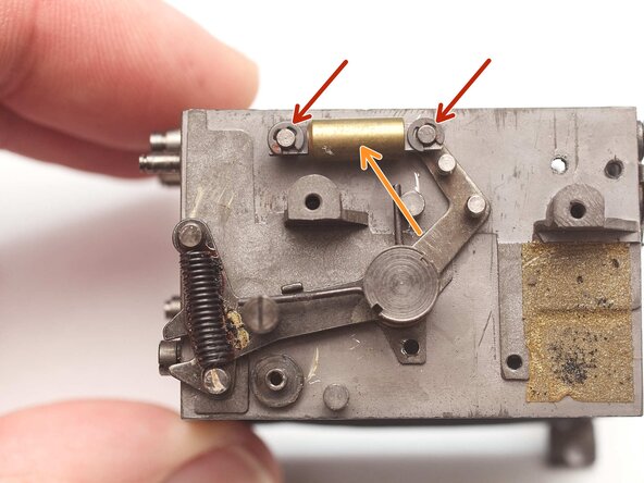

    9. Pentax MX Mirror Box Mechanism Disassembly, Remove air damper: step 27, image 1 of 1
      • Remove two M1.7 circlips.
      • Lift off air damper.
      • Separate the air damper halves and clean with isopropyl alcohol.
      Ask FixBot

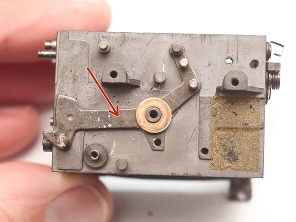

    10. Pentax MX Mirror Box Mechanism Disassembly, Remove mirror return lever: step 28, image 1 of 3 Pentax MX Mirror Box Mechanism Disassembly, Remove mirror return lever: step 28, image 2 of 3 Pentax MX Mirror Box Mechanism Disassembly, Remove mirror return lever: step 28, image 3 of 3
      • Detach and remove mirror lifting spring.
      • Detach mirror return spring.
      • The spring is very stiff. Use pliers rather than tweezers to detach.
      • Remove lever screw using a spanner wrench. The return spring may still have some tension in it.
      • Lift off mirror return lever.
      • Remove shim washers.
      • This piece of foam is used to silence the coil spring. It can be replaced or removed. If removed, a small piece of heat shrink placed around the coil spring can act as a silencer.

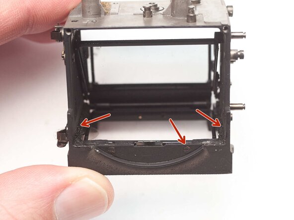

    12. Pentax MX Mirror Box Mechanism Disassembly, Clean mirror box and mechanism: step 30, image 1 of 2 Pentax MX Mirror Box Mechanism Disassembly, Clean mirror box and mechanism: step 30, image 2 of 2
      • Clean all shafts on the mirror box with isopropyl alcohol. Remove any other visible grease.
      • Clean all levers and mechanism parts especially the pivots.
      • Lubrication for the mirror box mechanism is minimal. No oil is recommended.
      • A heavy molybdenum grease should be used on high friction latching points to reduce wear.
      • This is also a good time to replace the mirror bumper foam.
