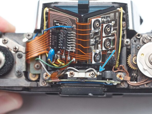

    1. Pentax MX Viewfinder Disassembly, Unsolder connections: step 5, image 1 of 3 Pentax MX Viewfinder Disassembly, Unsolder connections: step 5, image 2 of 3 Pentax MX Viewfinder Disassembly, Unsolder connections: step 5, image 3 of 3
      • Unsolder one blue wire for the LED switch.
      • Unsolder one green wire for the motor drive.
      • Unsolder two yellow wires for the aperture resistor.
      • Unsolder two brown wires for the shutter speed resistor.
      • Unsolder one gray wire for flash sync.

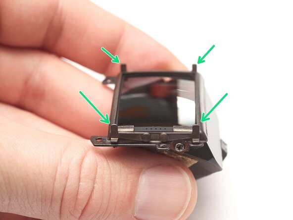

    3. Pentax MX Viewfinder Disassembly: step 11, image 1 of 2 Pentax MX Viewfinder Disassembly: step 11, image 2 of 2
      • Remove two screws.
      • Remove two retaining clamps.
      • Lift off the prism.
      • Installation Notes: Position the stand-off posts so that they are all at the corners of the frame.

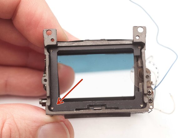

    4. Pentax MX Viewfinder Disassembly, Remove focusing screen seat: step 12, image 1 of 1
      • Remove focusing screen seat.
