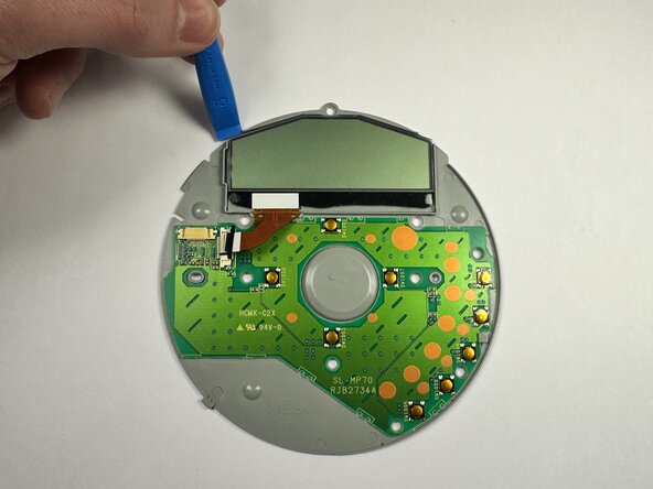

If your Panasonic SL-MP73J screen is cracked or damaged, use this guide to replace it. When functional, the screen displays the number of tracks in the CD, the total playtime, the number of albums, and the number of tracks. Take care when replacing this part, as it is connected by a delicate ribbon cable. Before replacing this component, make sure the batteries are removed from the device.

    6. Panasonic SL-MP73J Screen Replacement: step 6, image 1 of 2 Panasonic SL-MP73J Screen Replacement: step 6, image 2 of 2
      • Slide your plastic prying tool under the top left of the screen and slide it along the edge to detach the screen from the adhesive.
