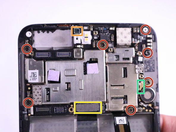

    1. OnePlus 5 Screen Assembly Replacement, Screen with Assembly: step 1, image 1 of 3 OnePlus 5 Screen Assembly Replacement, Screen with Assembly: step 1, image 2 of 3 OnePlus 5 Screen Assembly Replacement, Screen with Assembly: step 1, image 3 of 3
      • Remove the seven 1mm Phillips #0 screws by rotating screwdriver counter clockwise.
      • Remove the earpiece speaker connector located on the top of the motherboard using a nylon spudger by prying underneath it.
      • Remove the LCD screen connector located on the bottom of the motherboard using a nylon spudger by prying underneath it.
      • Disconnect the antenna wire located on the right side of the motherboard using a nylon spudger by prying underneath it.
      • The antenna wire will be clipped onto the motherboard so make sure it is fully unclipped before removing the motherboard.

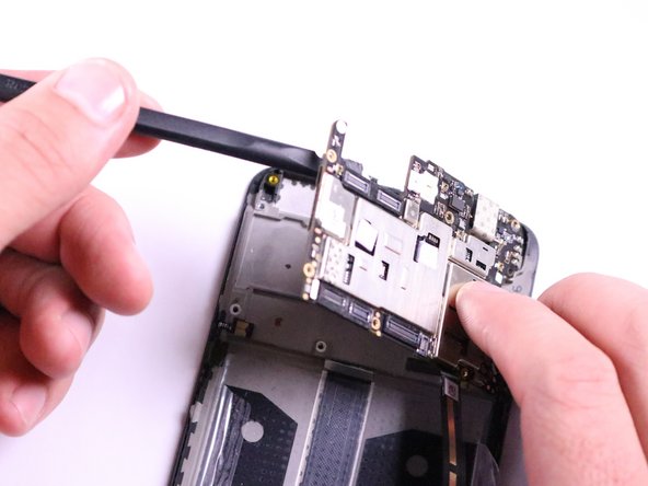

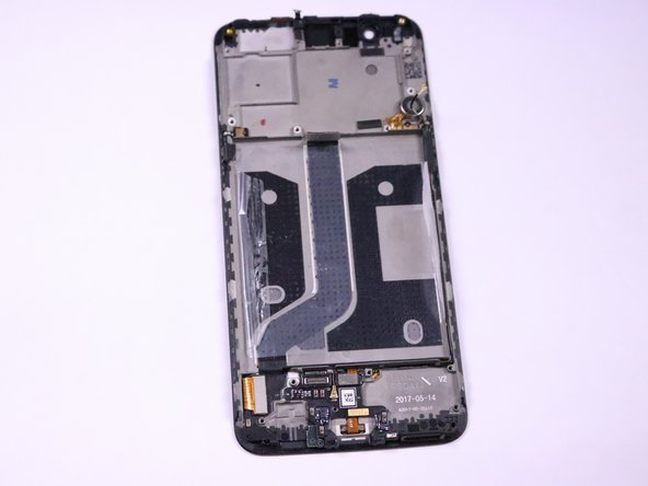

    2. OnePlus 5 Screen Assembly Replacement: step 2, image 1 of 3 OnePlus 5 Screen Assembly Replacement: step 2, image 2 of 3 OnePlus 5 Screen Assembly Replacement: step 2, image 3 of 3
      • Remove the motherboard by gently pushing the spudger underneath upper right hand corner of the motherboard and prying it out.
