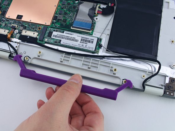

    1. One Education Infinity Handle Replacement, Handle: step 4, image 1 of 3 One Education Infinity Handle Replacement, Handle: step 4, image 2 of 3 One Education Infinity Handle Replacement, Handle: step 4, image 3 of 3
      • Using the Phillips #00, remove the two 4.7 mm screws securing the handle to the case.
      Ask FixBot
    2. One Education Infinity Handle Replacement: step 5, image 1 of 2 One Education Infinity Handle Replacement: step 5, image 2 of 2
      • Remove the handle from the device.
