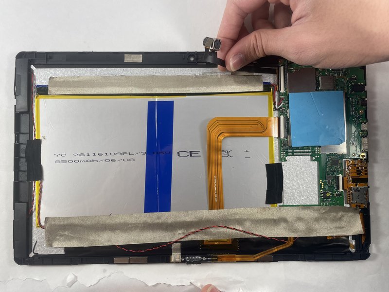

      • Place the flat end of a nylon spudger in the gap between the cover and the rest of the device.
      • Slide the spudger down each side until you hear numerous clicks.
      • Remove the back panel from the tablet.

      • Disconnect the ribbon cable from its retaining flap.

      • Lift the camera out of the tablet.
      • The camera may be glued into place, so use caution when removing it.
      Ask FixBot
