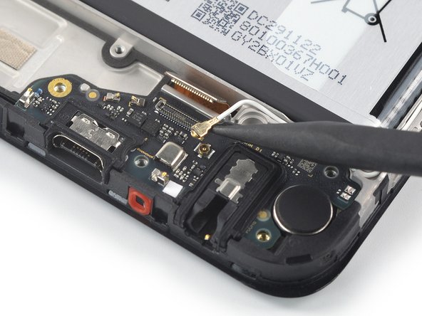

  20. Nokia G22 Charging Port Assembly Replacement, Disconnect the antenna cable: step 20, image 1 of 2 Nokia G22 Charging Port Assembly Replacement, Disconnect the antenna cable: step 20, image 2 of 2
    • Use the pointed end of a spudger to disconnect the antenna cable by prying the connector straight up from its socket on the charging port assembly.

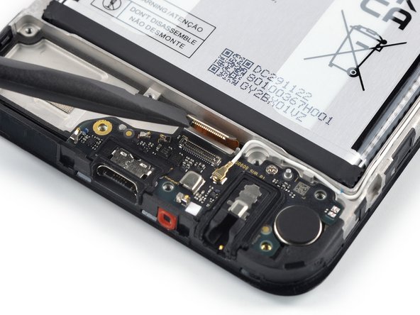

  21. Nokia G22 Charging Port Assembly Replacement, Unfasten the charging port assembly: step 21, image 1 of 1
    • Use a Phillips screwdriver to remove the 2.8 mm‑long screw securing the charging port assembly.

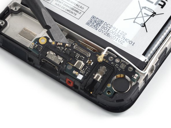

  22. Nokia G22 Charging Port Assembly Replacement, Pry up the charging port assembly: step 22, image 1 of 2 Nokia G22 Charging Port Assembly Replacement, Pry up the charging port assembly: step 22, image 2 of 2
    • Insert the flat end of a spudger underneath the top edge of the charging port assembly.
    • Pry up the charging port assembly by twisting the spudger until you can grip it with your fingers.

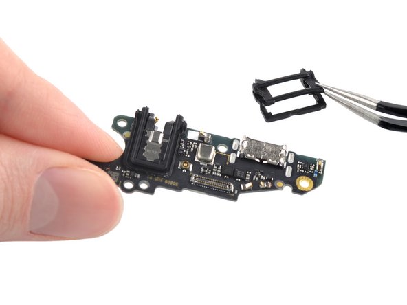

  24. Nokia G22 Charging Port Assembly Replacement, Remove the rubber gaskets: step 24, image 1 of 3 Nokia G22 Charging Port Assembly Replacement, Remove the rubber gaskets: step 24, image 2 of 3 Nokia G22 Charging Port Assembly Replacement, Remove the rubber gaskets: step 24, image 3 of 3
    Tool used on this step:
    Buy
    • Use a pair of tweezers to remove the black rubber gaskets from the charging port and the headphone jack.
    • During reassembly, transfer the rubber gaskets to your replacement part before securing it to the frame.
