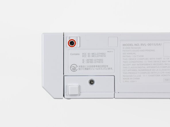

    1. Nintendo Wii Motherboard Replacement, Faceplate: step 1, image 1 of 2 Nintendo Wii Motherboard Replacement, Faceplate: step 1, image 2 of 2
      • Use a metal spudger to remove the white plastic screw covers stuck to the lower case near the front of the Wii.
      Ask FixBot
    2. Nintendo Wii Motherboard Replacement: step 2, image 1 of 1
      • Remove the two 8.3 mm Tri-Point screws hidden under the covers you just removed.
      Ask FixBot

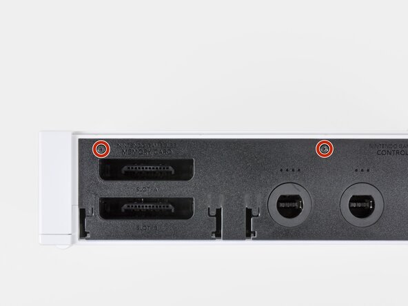

    2. Nintendo Wii Motherboard Replacement: step 8, image 1 of 2 Nintendo Wii Motherboard Replacement: step 8, image 2 of 2
      • Remove the two remaining 4.1 mm Phillips screws along the top edge of the black plastic controller port bezel.
      • Lift the bezel from the long edge furthest away from the controller ports and remove it from the Wii.
