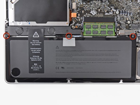

    2. MacBook Pro 17" Unibody Battery Replacement: step 4, image 1 of 1
      • Remove the three 6.5 mm Tri-point screws securing the battery to the upper case.

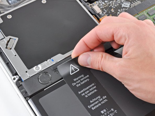

    3. MacBook Pro 17" Unibody Battery Replacement: step 5, image 1 of 2 MacBook Pro 17" Unibody Battery Replacement: step 5, image 2 of 2
      • Use a plastic opening tool or another soft thin-edged tool to carefully lift up a corner of the "Warning: Do not remove the battery" sticker off the right speaker/subwoofer enclosure.
      • Peel the sticker off the right speaker/subwoofer enclosure.
      • It is not necessary to completely peel the sticker off the battery.
