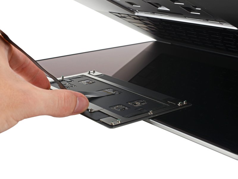

    2. MacBook Pro 16" 2021 Trackpad Replacement, Remove the trackpad: step 2, image 1 of 3 MacBook Pro 16" 2021 Trackpad Replacement, Remove the trackpad: step 2, image 2 of 3 MacBook Pro 16" 2021 Trackpad Replacement, Remove the trackpad: step 2, image 3 of 3
      • Swing the display open slightly, but keep the MacBook upside-down. The trackpad assembly should separate and lay flat on the display.
      • Carefully feed the trackpad's ribbon cable through its slot in the frame.

    3. MacBook Pro 16" 2021 Trackpad Replacement: step 3, image 1 of 3 MacBook Pro 16" 2021 Trackpad Replacement: step 3, image 2 of 3 MacBook Pro 16" 2021 Trackpad Replacement: step 3, image 3 of 3
      • As you remove the trackpad assembly, be very careful not to lose the nine small metal washers resting on the screw posts. (They will fly off and get lost with very little provocation.)
      • Remove the trackpad assembly.
