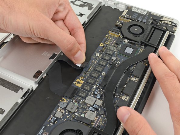

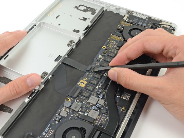

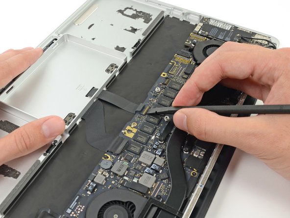

    1. MacBook Pro 13" Retina Display Late 2012 Trackpad Replacement, SSD Assembly: step 21, image 1 of 3 MacBook Pro 13" Retina Display Late 2012 Trackpad Replacement, SSD Assembly: step 21, image 2 of 3 MacBook Pro 13" Retina Display Late 2012 Trackpad Replacement, SSD Assembly: step 21, image 3 of 3
      • Use your thumb or finger to bend the plastic spring bar on the SSD tray, freeing the two clips at the front side of the device.
      • While holding the spring bar depressed, tilt the SSD assembly up out of its cavity.
      Ask FixBot
    2. MacBook Pro 13" Retina Display Late 2012 Trackpad Replacement: step 22, image 1 of 1
      • Remove the SSD assembly from the upper case.
      Ask FixBot

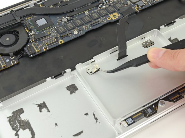

    1. MacBook Pro 13" Retina Display Late 2012 Trackpad Replacement, Battery: step 23, image 1 of 2 MacBook Pro 13" Retina Display Late 2012 Trackpad Replacement, Battery: step 23, image 2 of 2
      • Remove three 2.2 mm T5 Torx screws from each side of the battery (six screws total).
      Ask FixBot

    3. MacBook Pro 13" Retina Display Late 2012 Trackpad Replacement: step 25, image 1 of 2 MacBook Pro 13" Retina Display Late 2012 Trackpad Replacement: step 25, image 2 of 2
      • Now that your MacBook Pro is fully prepped, it's time to prep yourself.
      • iFixit adhesive remover contains acetone, a mild skin and eye irritant.
      • Wear eye protection when handling and applying the adhesive remover. (Eye protection is included in your kit.)
      • Do not wear contact lenses without eye protection.
      • Protective gloves are also included in your kit. If you are concerned about skin irritation, put your gloves on now.
      Ask FixBot
    4. MacBook Pro 13" Retina Display Late 2012 Trackpad Replacement: step 26, image 1 of 3 MacBook Pro 13" Retina Display Late 2012 Trackpad Replacement: step 26, image 2 of 3 MacBook Pro 13" Retina Display Late 2012 Trackpad Replacement: step 26, image 3 of 3
      • Pull off the black rubber stopper from your bottle of adhesive remover.
      • Twist to loosen or remove the bottle cap before you cut the applicator tip.
      • This unseals the bottle and allows the pressure to equalize before you cut the applicator tip. If you skip this step, the adhesive remover may spray out unexpectedly when the tip is cut.
      • Use scissors to cut off the sealed tip of the applicator.
      • Cutting close to the narrow tip will give you better control so you can apply the adhesive remover in small amounts.
      • Twist and close the bottle cap securely before you proceed further.
      Ask FixBot

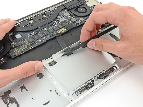

    5. MacBook Pro 13" Retina Display Late 2012 Trackpad Replacement: step 27, image 1 of 1
      • Apply a few drops of adhesive remover evenly under the edge of the leftmost battery cell.
      • You don't need to use very much. The small bottle contains more than twice the amount of solvent needed to remove all the battery cells.
      • Wait 2-3 minutes for the liquid adhesive remover to penetrate underneath the battery cell before you proceed to the next step.
      Ask FixBot

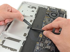

    6. MacBook Pro 13" Retina Display Late 2012 Trackpad Replacement: step 28, image 1 of 3 MacBook Pro 13" Retina Display Late 2012 Trackpad Replacement: step 28, image 2 of 3 MacBook Pro 13" Retina Display Late 2012 Trackpad Replacement: step 28, image 3 of 3
      Tool used on this step:
      Plastic Cards
      $2.99
      Buy
      • Insert the flat edge of a spudger or plastic card underneath the leftmost battery cell.
      • Run your tool along the bottom perimeter of the battery cell and lift to begin separating the adhesive.
      Ask FixBot
    7. MacBook Pro 13" Retina Display Late 2012 Trackpad Replacement: step 29, image 1 of 3 MacBook Pro 13" Retina Display Late 2012 Trackpad Replacement: step 29, image 2 of 3 MacBook Pro 13" Retina Display Late 2012 Trackpad Replacement: step 29, image 3 of 3
      • Insert the spudger along the left-hand side of the leftmost battery cell.
      • Run the spudger up along the left side of the leftmost battery cell.
      • Slightly pry the leftmost battery cell to release it from the adhesive.
      Ask FixBot

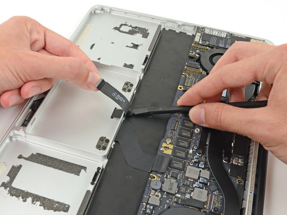

    8. MacBook Pro 13" Retina Display Late 2012 Trackpad Replacement: step 30, image 1 of 3 MacBook Pro 13" Retina Display Late 2012 Trackpad Replacement: step 30, image 2 of 3 MacBook Pro 13" Retina Display Late 2012 Trackpad Replacement: step 30, image 3 of 3
      • Repeat the above steps to separate the adjacent battery cell from its adhesive:
      • Apply a few drops of liquid adhesive remover under the battery cell.
      • Wait 2-3 minutes for the adhesive remover to penetrate and soften the adhesive.
      • Carefully wedge a spudger or plastic card inwards, being careful to not damage the battery, and separate the battery cell from the adhesive securing it to your MacBook Pro.
      Ask FixBot
    9. MacBook Pro 13" Retina Display Late 2012 Trackpad Replacement: step 31, image 1 of 3 MacBook Pro 13" Retina Display Late 2012 Trackpad Replacement: step 31, image 2 of 3 MacBook Pro 13" Retina Display Late 2012 Trackpad Replacement: step 31, image 3 of 3
      • Insert the flat end of a spudger underneath the larger leftmost battery cell.
      • Carefully wedge the spudger inwards, being careful to not damage the battery cells.
      • Pry the larger leftmost battery cell up off the upper case.
      Ask FixBot

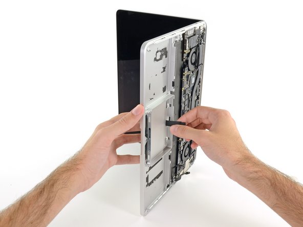

    10. MacBook Pro 13" Retina Display Late 2012 Trackpad Replacement: step 32, image 1 of 3 MacBook Pro 13" Retina Display Late 2012 Trackpad Replacement: step 32, image 2 of 3 MacBook Pro 13" Retina Display Late 2012 Trackpad Replacement: step 32, image 3 of 3
      • Grasp the battery cells and gently move (but do not remove) them from their recess in the upper case.
      • Leave the battery cells resting on top of the upper case as shown in the third picture.
      Ask FixBot

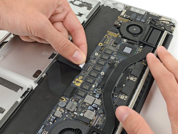

    11. MacBook Pro 13" Retina Display Late 2012 Trackpad Replacement: step 33, image 1 of 3 MacBook Pro 13" Retina Display Late 2012 Trackpad Replacement: step 33, image 2 of 3 MacBook Pro 13" Retina Display Late 2012 Trackpad Replacement: step 33, image 3 of 3
      • Switch sides and repeat the above procedure for the two battery cells on the right-hand side of the MacBook Pro.
      • Remember to add a small amount of liquid adhesive remover under each battery cell, and wait 2-3 minutes for it to penetrate before prying up the cell.
      • Be careful not to puncture or otherwise damage the battery cells.
      Ask FixBot
    12. MacBook Pro 13" Retina Display Late 2012 Trackpad Replacement: step 34, image 1 of 3 MacBook Pro 13" Retina Display Late 2012 Trackpad Replacement: step 34, image 2 of 3 MacBook Pro 13" Retina Display Late 2012 Trackpad Replacement: step 34, image 3 of 3
      • Lift the battery as a whole up out of the upper case, and remove the battery.
      • Before installing a new battery, remove all the old adhesive from the MacBook Pro's case.
      • With a little luck, you can slowly pull out each strip of adhesive with your fingers.
      • Otherwise, soak each section of adhesive with a bit of adhesive remover for 2-3 minutes, and then scrape it out with an opening pick or one of the other tools in your kit. This can take quite a bit of work, so be patient.

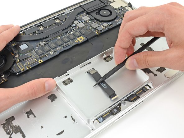

    1. MacBook Pro 13" Retina Display Late 2012 Trackpad Replacement, Trackpad: step 35, image 1 of 2 MacBook Pro 13" Retina Display Late 2012 Trackpad Replacement, Trackpad: step 35, image 2 of 2
      • Use the flat end of a spudger to flip up the retaining flap on the trackpad ribbon cable ZIF socket.
      Ask FixBot
    2. MacBook Pro 13" Retina Display Late 2012 Trackpad Replacement: step 36, image 1 of 2 MacBook Pro 13" Retina Display Late 2012 Trackpad Replacement: step 36, image 2 of 2
      • Grasp the plastic pull tab and pull the trackpad ribbon cable out of its socket.

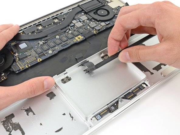

    3. MacBook Pro 13" Retina Display Late 2012 Trackpad Replacement: step 37, image 1 of 2 MacBook Pro 13" Retina Display Late 2012 Trackpad Replacement: step 37, image 2 of 2
      • Wedge the spudger between the trackpad ribbon cable and the upper case.
      • Run the spudger along the bottom to release the trackpad ribbon cable from the adhesive securing it to the upper case.
      Ask FixBot
    4. MacBook Pro 13" Retina Display Late 2012 Trackpad Replacement: step 38, image 1 of 2 MacBook Pro 13" Retina Display Late 2012 Trackpad Replacement: step 38, image 2 of 2
      • Insert the tip of a spudger in between the trackpad ribbon cable and the upper case inside the SSD assembly cavity to remove the last of the adhesive.
      Ask FixBot
    5. MacBook Pro 13" Retina Display Late 2012 Trackpad Replacement: step 39, image 1 of 3 MacBook Pro 13" Retina Display Late 2012 Trackpad Replacement: step 39, image 2 of 3 MacBook Pro 13" Retina Display Late 2012 Trackpad Replacement: step 39, image 3 of 3
      • Using the tip of the spudger carefully thread the trackpad ribbon cable out of the notch near the top of the SSD assembly cavity.

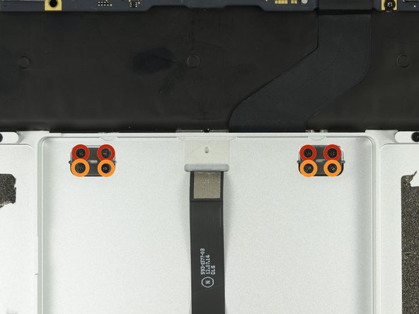

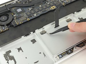

    6. MacBook Pro 13" Retina Display Late 2012 Trackpad Replacement: step 40, image 1 of 1
      • Remove the following screws securing the trackpad brackets to the trackpad and upper case:
      • Four 1.9 mm Phillips #000 screws
      • Four 1.4 mm Phillips #000 screws
      Ask FixBot

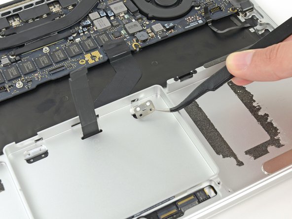

    7. MacBook Pro 13" Retina Display Late 2012 Trackpad Replacement: step 41, image 1 of 3 MacBook Pro 13" Retina Display Late 2012 Trackpad Replacement: step 41, image 2 of 3 MacBook Pro 13" Retina Display Late 2012 Trackpad Replacement: step 41, image 3 of 3
      Buy
      • Use tweezers to remove the two trackpad mounting brackets from the upper case.

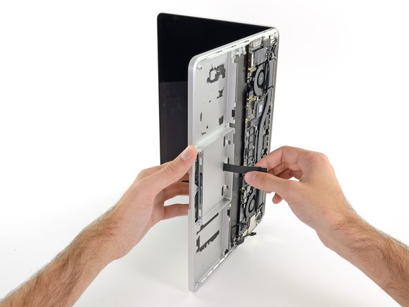

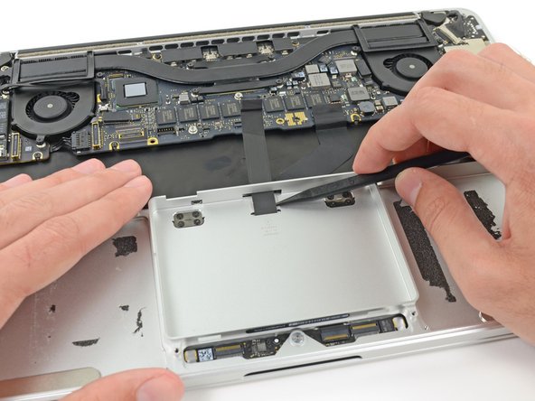

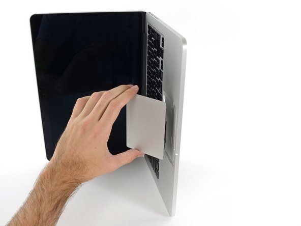

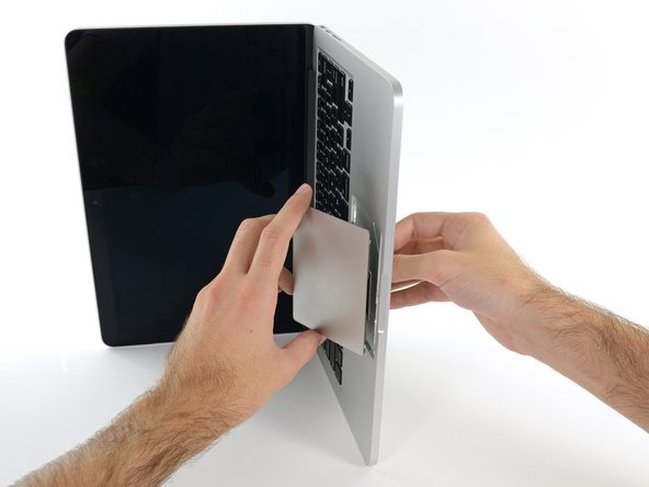

    8. MacBook Pro 13" Retina Display Late 2012 Trackpad Replacement: step 42, image 1 of 2 MacBook Pro 13" Retina Display Late 2012 Trackpad Replacement: step 42, image 2 of 2
      • To avoid scratching the display, open the computer about 90º and set it on end.
      • Guide the trackpad ribbon cable through the slot cut in the upper case. This will push the trackpad up out of its recess in the top of the upper case. Guide the trackpad out with your other hand, so it doesn't fall.
      Ask FixBot

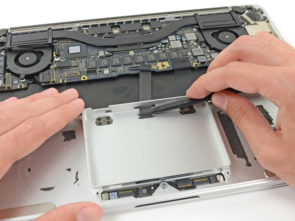

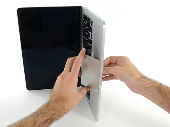

    9. MacBook Pro 13" Retina Display Late 2012 Trackpad Replacement: step 43, image 1 of 3 MacBook Pro 13" Retina Display Late 2012 Trackpad Replacement: step 43, image 2 of 3 MacBook Pro 13" Retina Display Late 2012 Trackpad Replacement: step 43, image 3 of 3
      • Gently pull the trackpad from the upper case, being careful not to snag the ribbon cable.
