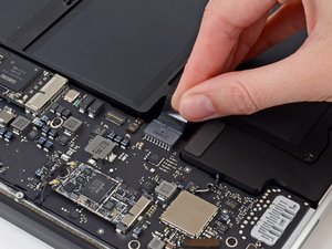

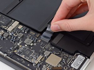

    1. MacBook Air 13" Early 2014 Solid-State Drive Replacement, Battery Connector: step 3, image 1 of 2 MacBook Air 13" Early 2014 Solid-State Drive Replacement, Battery Connector: step 3, image 2 of 2
      • To ensure that everything is de-energized and won't turn on while you're working, it is recommended that you disconnect the battery.
      • Grab the clear plastic pull tab attached to the battery connector and pull it parallel to the board toward the front edge of the Air.
      • Do not lift upward on the connector as you disconnect it or you risk damage to the connector socket.
      Ask FixBot

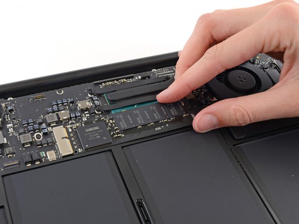

    2. MacBook Air 13" Early 2014 Solid-State Drive Replacement: step 5, image 1 of 2 MacBook Air 13" Early 2014 Solid-State Drive Replacement: step 5, image 2 of 2
      • Gently lift the end of the SSD about half an inch and pull it straight out of its socket on the logic board.
      • Don't lift the SSD more than half an inch—doing so may damage the SSD or its socket on the logic board.
      • When reinstalling the SSD, be sure it is properly seated before reinstalling its retaining screw.
