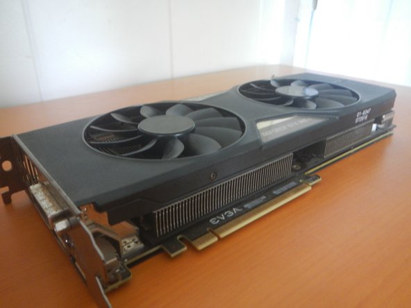

    4. Mac Pro 2009-2012 Graphics card  Replacement, Pull out the new graphics card and accessories: step 4, image 1 of 2 Mac Pro 2009-2012 Graphics card  Replacement, Pull out the new graphics card and accessories: step 4, image 2 of 2
      • Have your new graphics card nearby and any power cables if your GPU requires external power.
