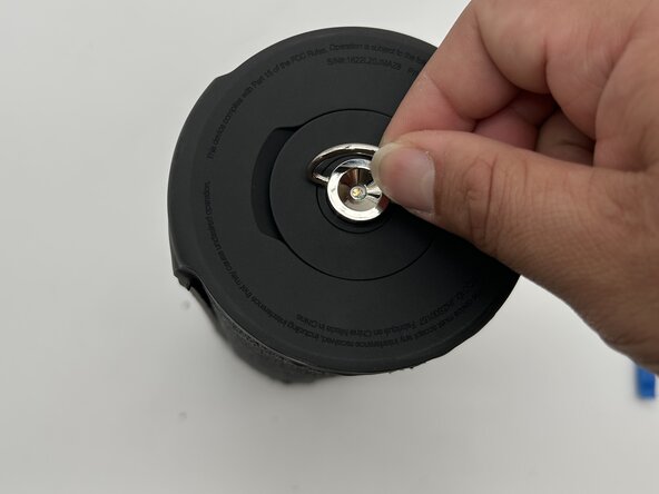

    1. Logitech UE Megablast Power Button Assembly Replacement, Power Button Assembly: step 1, image 1 of 2 Logitech UE Megablast Power Button Assembly Replacement, Power Button Assembly: step 1, image 2 of 2
      • Turn the silver D-ring on one end of the speaker counterclockwise with your fingers to remove it.
