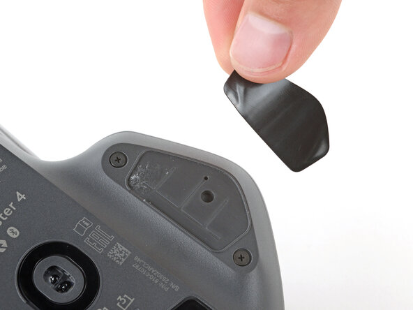

    3. Logitech MX Master 4 Feet Replacement, Remove the mouse feet: step 4, image 1 of 3 Logitech MX Master 4 Feet Replacement, Remove the mouse feet: step 4, image 2 of 3 Logitech MX Master 4 Feet Replacement, Remove the mouse feet: step 4, image 3 of 3
      • If any of the feet feel stuck when removing them, apply more heat and try again.
      • Slowly slide the tip of an opening pick under one of the feet.
      • Make sure the pick slides under both the foot and its adhesive pad—the two layers can easily separate.
      • Slide the pick farther under the foot and lift until you can grip the foot with your fingers.
      • Use your fingers to peel up and remove the foot.
      • If the foot separated from its adhesive pad, use the same process to remove the pad.

    5. Logitech MX Master 4 Feet Replacement, Install new mouse feet: step 6, image 1 of 2 Logitech MX Master 4 Feet Replacement, Install new mouse feet: step 6, image 2 of 2
      • To install new mouse feet:
      • Thoroughly clean all the foot recesses with isopropyl alcohol and a lint‑free or microfiber cloth. Allow the surface to dry completely.
      • Peel your new mouse feet off their adhesive liners and press them firmly into place.
