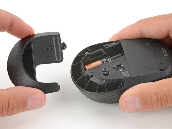

    2. Logitech M170 Battery Replacement, Remove the battery cover: step 2, image 1 of 3 Logitech M170 Battery Replacement, Remove the battery cover: step 2, image 2 of 3 Logitech M170 Battery Replacement, Remove the battery cover: step 2, image 3 of 3
      • Press down on the battery cover and slide it away from the mouse to remove it.
      Ask FixBot
    3. Logitech M170 Battery Replacement, Remove the battery: step 3, image 1 of 3 Logitech M170 Battery Replacement, Remove the battery: step 3, image 2 of 3 Logitech M170 Battery Replacement, Remove the battery: step 3, image 3 of 3
      • Use your fingers to lift the end of the battery and slide it out of its recess.
      • During reassembly, slide the battery in negative (-) end first, as shown on the engraving in the recess.
