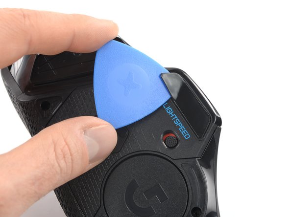

    3. Logitech G502 Lightspeed Feet Replacement, Remove the front foot: step 3, image 1 of 3 Logitech G502 Lightspeed Feet Replacement, Remove the front foot: step 3, image 2 of 3 Logitech G502 Lightspeed Feet Replacement, Remove the front foot: step 3, image 3 of 3
      • Insert the tip of an opening pick underneath the front foot at the gap in its recess.
      • The mouse feet are made of two layers. Make sure you insert the pick under the bottom layer to completely remove the foot.
      • When possible, grab with your fingers and slowly pull to peel it off completely.

    5. Logitech G502 Lightspeed Feet Replacement, Remove the rear foot: step 5, image 1 of 3 Logitech G502 Lightspeed Feet Replacement, Remove the rear foot: step 5, image 2 of 3 Logitech G502 Lightspeed Feet Replacement, Remove the rear foot: step 5, image 3 of 3
      • Insert the tip of an opening pick underneath the rear foot starting at the gap in its recess.
      • When installing a new foot:
      • Use a spudger to carefully scrape up and remove any remaining adhesive bits.
      • Use isopropyl alcohol and a microfiber cloth to thoroughly clean all adhesive residue from the foot recesses. Allow the surface to completely dry.
      • Remove the feet from their backing and firmly press them into place.
