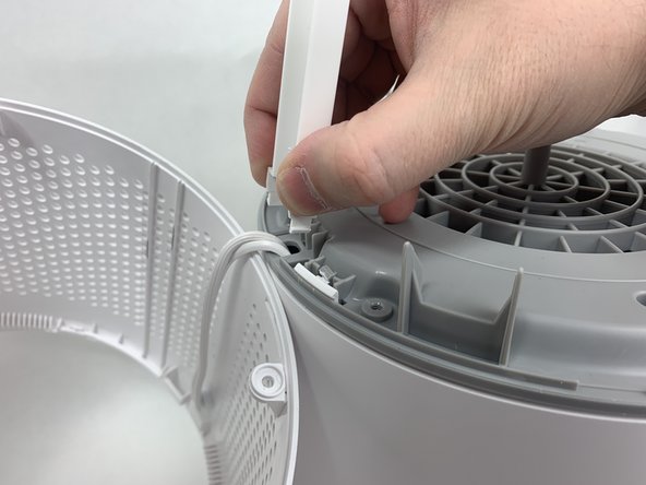

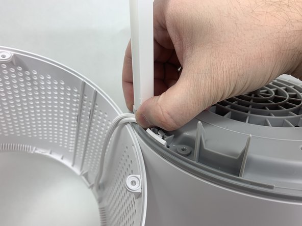

    4. Levoit Core 300-RAC Power Cord Replacement: step 7, image 1 of 3 Levoit Core 300-RAC Power Cord Replacement: step 7, image 2 of 3 Levoit Core 300-RAC Power Cord Replacement: step 7, image 3 of 3
      • Grab the cable channel by its base, squeeze, and pull up at the same time to remove it.
      Ask FixBot
