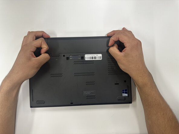

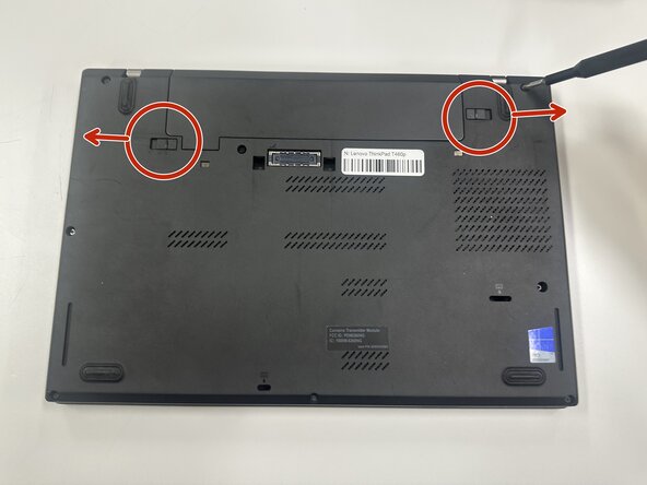

  1. Lenovo ThinkPad T460p RAM Replacement, Battery: step 1, image 1 of 3 Lenovo ThinkPad T460p RAM Replacement, Battery: step 1, image 2 of 3 Lenovo ThinkPad T460p RAM Replacement, Battery: step 1, image 3 of 3
    • Ensure the computer is shut down by depressing the power button above the keyboard.
    • Slide each of the two battery locking tabs toward the closest edge.
    • Remove the battery.
    • Reinstall the new battery by simply pushing it into the battery compartment; you do not need to hold the two retaining tabs back.
