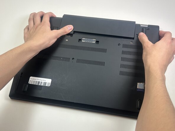

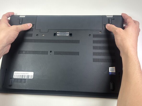

  2. Lenovo ThinkPad P51s SSD Replacement: step 2, image 1 of 3 Lenovo ThinkPad P51s SSD Replacement: step 2, image 2 of 3 Lenovo ThinkPad P51s SSD Replacement: step 2, image 3 of 3
    • Slide both locking latches outward using your thumbs.
    • Keep the right latch held in the unlocked position with your right thumb. With your left hand, push the battery out of the slot.
    • Once it detaches, use both hands to slide the battery out.

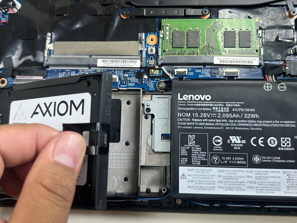

    • The SSD is located next to the internal battery.
  6. Lenovo ThinkPad P51s SSD Replacement: step 6, image 1 of 3 Lenovo ThinkPad P51s SSD Replacement: step 6, image 2 of 3 Lenovo ThinkPad P51s SSD Replacement: step 6, image 3 of 3
    • Press the plastic pull-tab inward toward the drive to release the locking mechanism.
    • Pull the tab outwards to slide the SSD and its caddy out.
    • Disconnect the SATA cable by pulling it straight out from the connector.
    • Do not pull on the cable wires themselves. Only pull from the connector to avoid damage.
