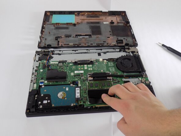

    1. Lenovo ThinkPad L460 RAM Replacement, RAM: step 6, image 1 of 1
      • Use your hands to flip the black flap covering the RAM module.
      Ask FixBot
    2. Lenovo ThinkPad L460 RAM Replacement: step 7, image 1 of 1
      • Use your hands to push out the metal clips on both sides of the RAM.
      • The RAM module will pop up at about a 30 degree angle when it's released from the metal arms.
      Ask FixBot
    3. Lenovo ThinkPad L460 RAM Replacement: step 8, image 1 of 1
      • Use your fingers to gently slide the RAM module out of its socket.
      Ask FixBot
