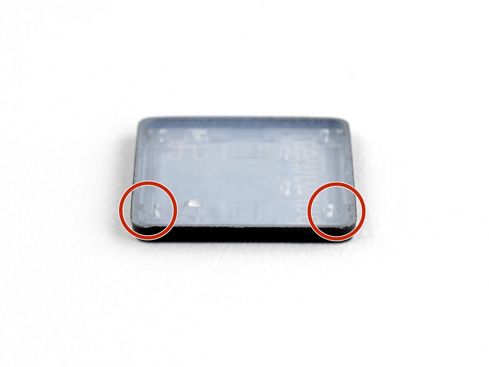

    7. Laptop Keyboard Cleaning Guide: step 7, image 1 of 1
      • To reinstall key caps, take note of where the clips are on the underside, then align the key with the key retainer and apply pressure with your finger to snap the clips back into place.
      • Be gentle as you reapply key caps—the clips that hold them in place are very fragile. If the cap doesn't snap back into place easily, don't force it. Check the alignment of the clips and try again.
