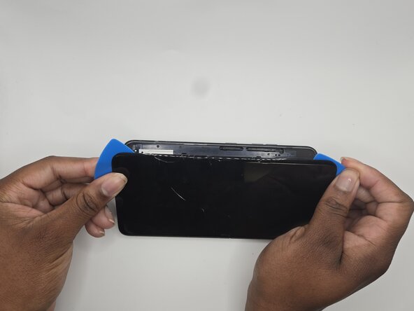

    2. LG V40 ThinQ Screen Replacement: step 11, image 1 of 2 LG V40 ThinQ Screen Replacement: step 11, image 2 of 2
      • Using the iOpener, heat up the screen.
      • You will know when the screen is hot enough when an Opening pick is able to slide under the screen.
      Ask FixBot
    3. LG V40 ThinQ Screen Replacement: step 12, image 1 of 2 LG V40 ThinQ Screen Replacement: step 12, image 2 of 2
      • Use Opening Picks to very gently pry the screen off.
      • The screen can crack and shatter very easily. Move slowly and carefully to avoid injury.
      Ask FixBot
