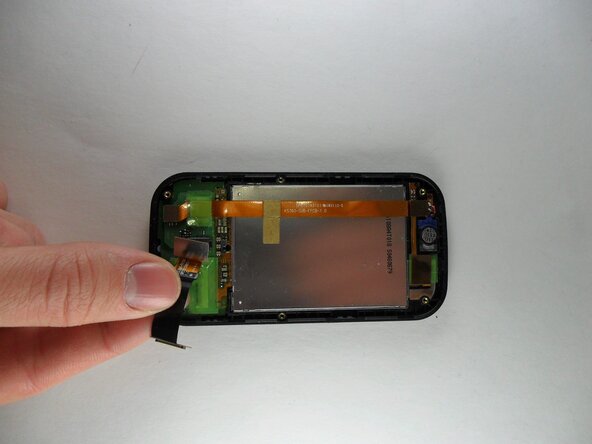

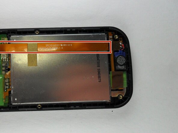

    7. LG Neon GT 365 Screen Replacement: step 7, image 1 of 2 LG Neon GT 365 Screen Replacement: step 7, image 2 of 2
      • Hold the horizontal copper ribbon down with 2 fingers on each side of the tape.
      • Lastly, carefully peel off the golden piece of tape circled, without ripping or damaging the copper ribbon and across the silver LCD.

    8. LG Neon GT 365 Screen Replacement: step 8, image 1 of 1
      • Now, disconnect the copper-colored ribbon. Pop off the ribbon and if it is still attached at the top that's ok.
