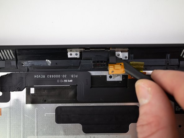

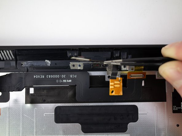

      • Pry up the microphone connector from the rear panel with the flat end of a spudger.
      • Pull up on the microphone with a pair of tweezers to remove.
