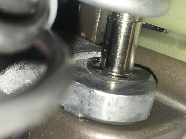

    9. Kenwood Chef Drive Gear replace, Motor: step 9, image 1 of 1
      • Remove three screws T20 and the plastic washers.
      Ask FixBot
    10. Kenwood Chef Drive Gear replace, Remove drive gear: step 10, image 1 of 3 Kenwood Chef Drive Gear replace, Remove drive gear: step 10, image 2 of 3 Kenwood Chef Drive Gear replace, Remove drive gear: step 10, image 3 of 3
      • Using a punch and a hammer push out the pin. (Note: support the gear on the opposite side to protect the the motor shaft from damage).
      • The gear ist free.
      • When inserting the pin, support the gear on the opposite side to protect the the motor shaft from damage.
      Ask FixBot
