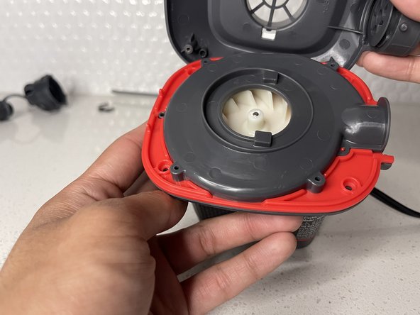

    4. Intex Quick-Fill AP636 Motor Assembly Replacement: step 4, image 1 of 1
      • Remove the top covering of the pump.
      Ask FixBot
    5. Intex Quick-Fill AP636 Motor Assembly Replacement: step 5, image 1 of 1
      • Remove the second cover.
      Ask FixBot
    6. Intex Quick-Fill AP636 Motor Assembly Replacement: step 6, image 1 of 1
      • Remove the red connection that holds motor assembly, removing it from the outer casing.
      Ask FixBot
    7. Intex Quick-Fill AP636 Motor Assembly Replacement: step 7, image 1 of 1
      • Disconnect the wire connections from motor.
