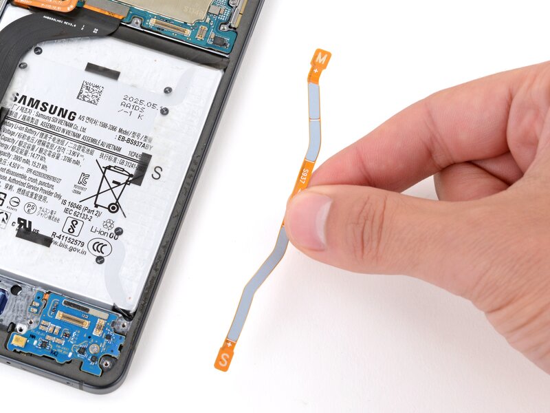

    1. Interconnect Cable Removal, Disconnect the interconnect cable: step 21, image 1 of 2 Interconnect Cable Removal, Disconnect the interconnect cable: step 21, image 2 of 2
      • Use the point of a spudger to pry up and disconnect the interconnect cable press connector (marked M) from the logic board.
      Ask FixBot
    2. Interconnect Cable Removal: step 22, image 1 of 2 Interconnect Cable Removal: step 22, image 2 of 2
      • Use the point of a spudger to pry up and disconnect the interconnect cable press connector (marked S) from the sub board.
      Ask FixBot
    3. Interconnect Cable Removal, Remove the interconnect cable: step 23, image 1 of 1
      • Remove the interconnect cable.
